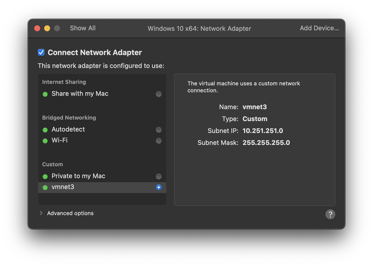

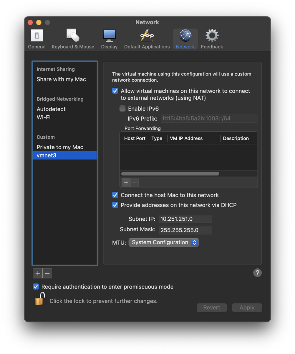

    Has anyone experiencing this issue tried adding a custom NAT network through VMware Fusion > Settings > Network and seeing if that works?
    - Paul (technogeezer)
    vExpert 2025

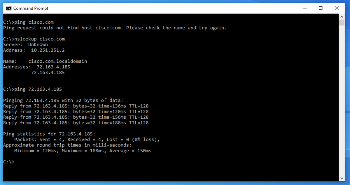

    Same results.
  • 19.  RE: Fusion DHCP not handing out a DNS server after upgrade to Sequoia 15.4
    Posted May 19, 2025 11:41 PM

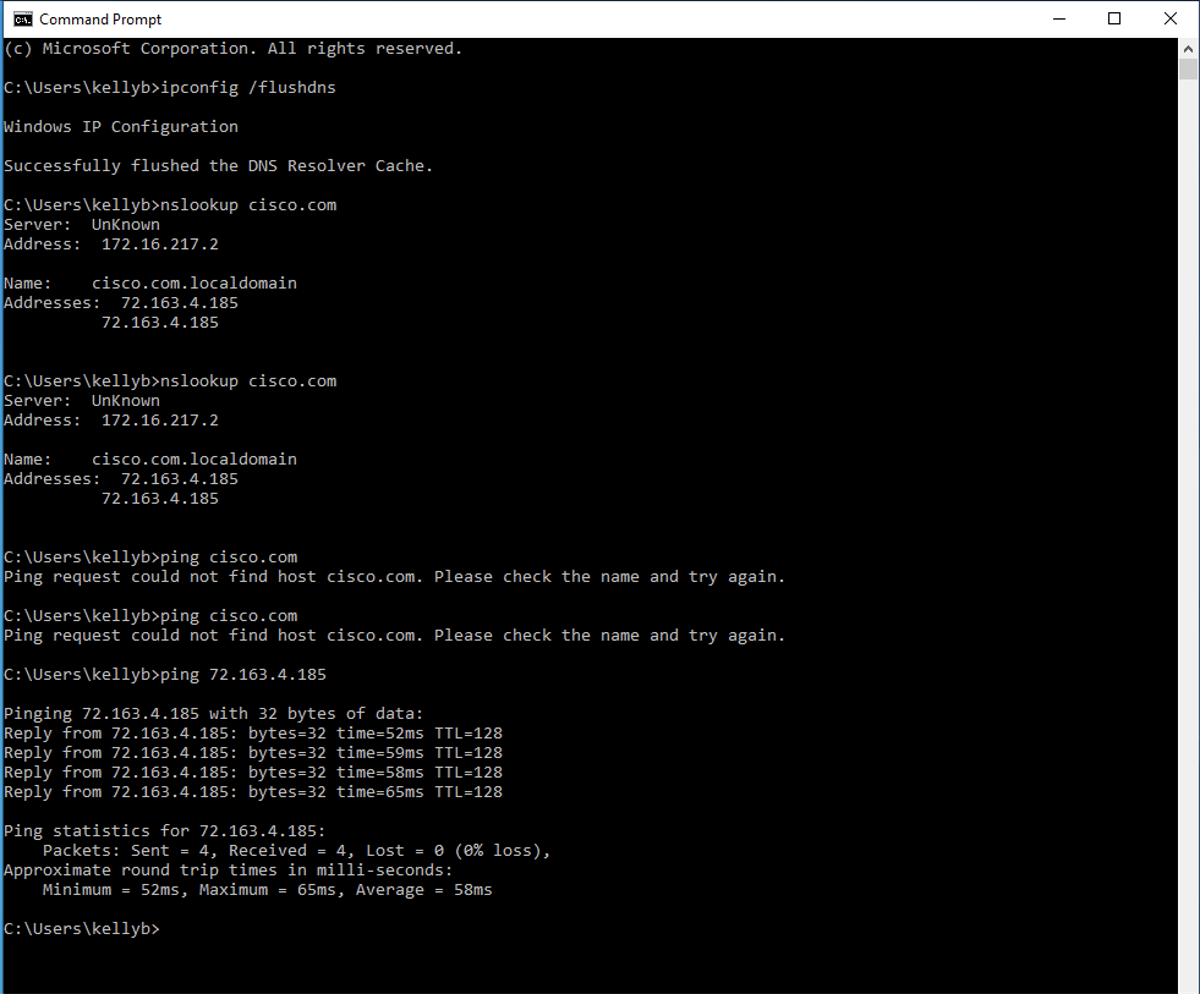

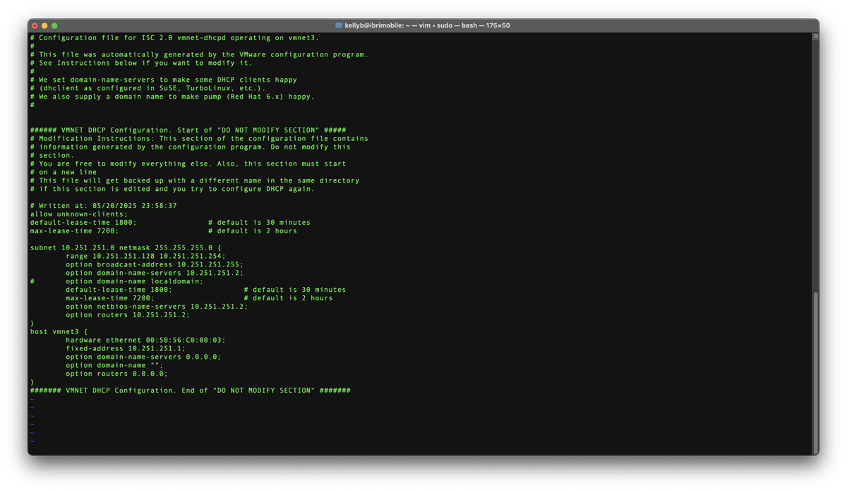

    I find it interesting that your nslookup cisco.com returns an address for cisco.com.localdomain.

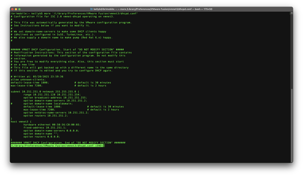

    Can you run a brief experiment on that new virtual network you've just created?
    Shut down the VM and the Fusion GUI.
    Open a terminal, and sudo to a root shell.
    Open /Library/Preferences/VMware Fusion/vmnet3/dhcpd.conf with your favorite command line text editor (e.g. vi)
    Locate the line:
            option domain-name localdomain;
    and change it to
            # option domain-name localdomain;
    Save and close the file.
    Start Fusion and the VM.
    Open a command prompt in Windows, run the following commands and post the output (please copy/paste the text from the terminal window into your reply and not a screen shot -- it's easier to deal with in text format).
    ipconfig /flushdns
    nslookup cisco.com
    nslookup cisco.com.
    ping cisco.com
    ping cisco.com.
    vExpert 2025
  • 20.  RE: Fusion DHCP not handing out a DNS server after upgrade to Sequoia 15.4
    Posted May 21, 2025 09:44 AM
    Same results.

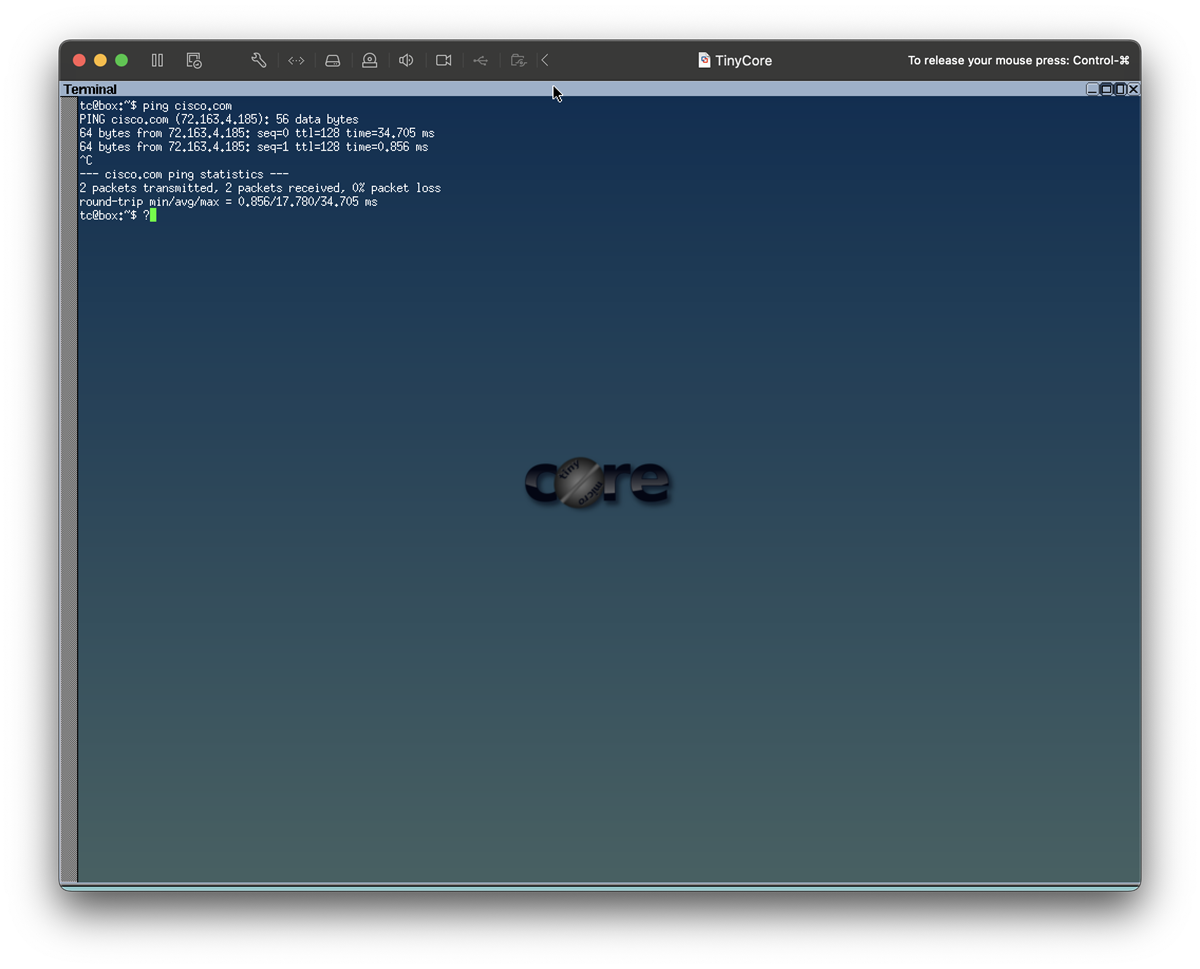

    Also this seems to be just a Windows thing. Booting a TinyCore Linux ISO seems to work properly.
    This is on my Intel PowerBook -- I also have an ARM PowerBook that performs the same way.
    One other note -- I built a fresh Windows VM that exhibited the same symptoms.

    I think you may have edited the dhcpd.conf file for the wrong vmnet. Which file did you edit and which virtual network are you running in that Windows VM? The file you edited has a NAT network segment of 10.251.251.0/24 but the VM is reporting it's using the resolver for the 172.16.217.0/24 network - which is telling me that the virtual network for the Windows VM is not set to the virtual network you edited.
    vExpert 2025
  • 22.  RE: Fusion DHCP not handing out a DNS server after upgrade to Sequoia 15.4
    Posted Jun 01, 2025 11:13 PM
    So I went through and double checked -- not sure how that other IP got it, this time it's not there.
    C:\>ipconfig /flushdns
    Windows IP Configuration
    Successfully flushed the DNS Resolver Cache.
    C:\>ipconfig /all
       Host Name . . . . . . . . . . . . : DESKTOP-Q7TEJ70
       Primary Dns Suffix  . . . . . . . :
       Node Type . . . . . . . . . . . . : Hybrid
       IP Routing Enabled. . . . . . . . : No
       WINS Proxy Enabled. . . . . . . . : No
    Ethernet adapter Ethernet0:
       Connection-specific DNS Suffix  . :
       Description . . . . . . . . . . . : Intel(R) 82574L Gigabit Network Connection
       DHCP Enabled. . . . . . . . . . . : Yes
       Autoconfiguration Enabled . . . . : Yes
       IPv4 Address. . . . . . . . . . . : 10.251.251.128(Preferred)
       Subnet Mask . . . . . . . . . . . : 255.255.255.0
       Lease Obtained. . . . . . . . . . : Sunday, June 1, 2025 8:43:53 PM
       Lease Expires . . . . . . . . . . : Sunday, June 1, 2025 9:13:52 PM
       Default Gateway . . . . . . . . . : 10.251.251.2
       DHCP Server . . . . . . . . . . . : 10.251.251.254
       DNS Servers . . . . . . . . . . . : 10.251.251.2
       Primary WINS Server . . . . . . . : 10.251.251.2
       NetBIOS over Tcpip. . . . . . . . : Enabled
    C:\>nslookup cisco.com
    Server:  UnKnown
    Address:  10.251.251.2
    DNS request timed out.
        timeout was 2 seconds.
    *** Request to UnKnown timed-out
    C:\>nslookup cisco.com.
    Server:  UnKnown
    C:\>ping cisco.com
    Ping request could not find host cisco.com. Please check the name and try again.
    C:\>ping cisco.com.
    Ping request could not find host cisco.com.. Please check the name and try again.
    C:\>
    If there's anything else to try, let me know.

    If I didn't know better, and I don't, I'd start to wonder if Broadcom has a plan to dump Fusion. They're certainly not making any noises that would lead users to believe otherwise with their recent behaviour.
  • 26.  RE: Fusion DHCP not handing out a DNS server after upgrade to Sequoia 15.4
    Posted May 13, 2025 05:28 PM
    I had to rebuild my Mac Studio from factory install in order to resolve another issue and this issue was also resolved with VMWare Fusion. Not sure where in the underpinnings caused the problem. I could not connect to Apple Music, App Store or Apple TV, so this is why I reinstalled the system without restoring from a Time Machine backup.
