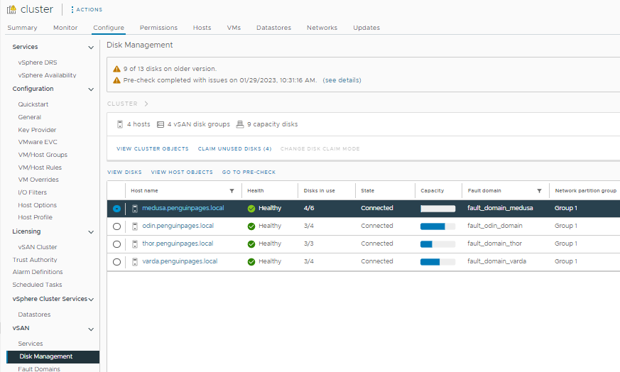

    More updates.  Trying to get vSAN fully "heathy and upgraded"
    Steps(after upgrade of esxi and vCenter to version
    1) Put each server in maintnence mode with data migration (if allowed) but most this failed so did it without migration
    2) reboot host (this seems to get some locks / services stuck on disk issue to let go)
    3) Remove disk
    4) Remove Partition (this is needed , as whenever you just add it back , even when listed as available, it just gots back into error state)
    5) Add disk back into disk group, or .. for one host I had to create a new disk group and move disk over to that pre above steps... but this assumes you have cache/ capacity disk to do that moving around
    Now all disk for all servers show heathy.. and each single disk group for one fault domain for each server is listed as "heathy".

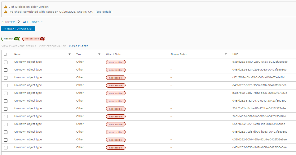

    But this leaves me with last issue.  I still cannot clear out what I see as "ghost objects"

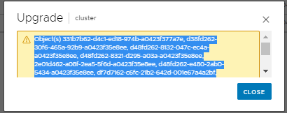

    And that .. is what I think is stopping the upgrade of format on disk for vSAN to be fully heathy.
    So I still in the same situation.  I cannot clear out these ghost objects.   Last two times I got to this stage the only fix was to delete the entire vSAN structure and rebuild from scratch.  But there needs to be a means to remediate these lost objects.   If you track down placement.. the disk they are are "heathy" so not sure what is step to fix the issue.

     It is unclear whether you are asking about deleting vSAN partitions off disks or deleting objects (which are likely as a result of deleting disks with host in MM with 'No Action' option and/or dragged from previous cluster).
    vSAN disk partitions don't need Linux live-boot to wipe - these can be wiped via the vSphere Disk Management UI or they can the disks can be erased from the vSphere/Host client 'erase partitions' utility or as a last measure using dd on the first 50MB + partedUtil mklabel .

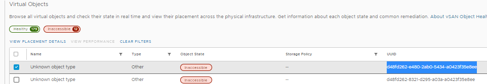

    With regard to inaccessible objects - these are probably still being clung to by vSAN due to having remaining components still on disk - if you are positive you don't need any of these (e.g. if this is a test-lab and no important VM non-functional/missing) then these can be permanently deleted using objtool e.g.:
    /usr/lib/vmware/osfs/bin/objtool delete -u <UUID> -f -v10

    1) Orphaned objects
    2) Upgrade Disk to latest version (failing due to object issues.
    Is there a means after running a single object delete to validate replica state .. or do some form of check validation?

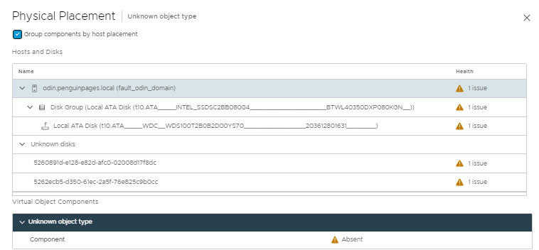

    Ex: of first object in list with issue
    d48fd262-e480-2ab0-5434-a0423f35e8ee
    The object is on one server that is live, heathy, and the physical disk is present and heathy.
    But the replica is "Unknown disks"   with out any note of node or target.
    What would be prefered is to have it move these chunklet / objects into some kind of "garbage mode" where they could be retrieved.
    Or to back trace the "Unknown disks" to where the clean up could be done with better confidence of what VM it would effect. (though I realize this is at lower level then a VM.
