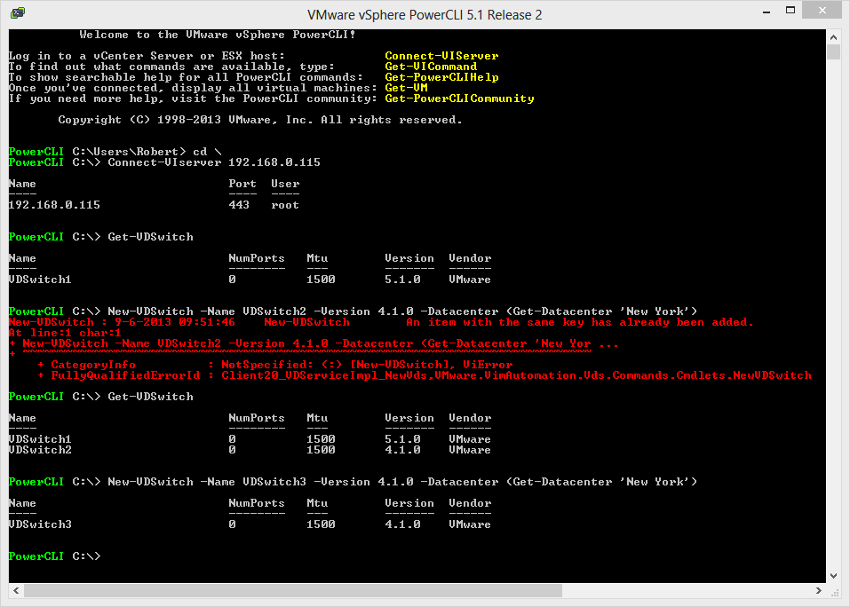

    I have the exact same problem when I add a vSphere Distributed Switch. The first switch I add in a PowerCLI session will give the "An item with the same key has already been added" error, although the switch seems to be created fine. All other switches I create in the same session don't give this error. See the attached screenshot for a complete session.

    Very interesting to know this is occuring for other object types.  I'm curious if getting the error once for any object will make it not occur for others.  In other words, sad as it is I'm thinking of creating a "fake" object in my script in order to force the error once and trap it.  That is at least until as real resolution can be found on the problem.
    Unfortunately I can't just trap the actual code when I'm trying to create a real VM, as the it doesn't return the task object when the error occurs.  That means that Wait-Task doesn't work, and the rest of the script pretty much fails.  As you mentioned with your Distributed Switch, the VM does get created in my case too.

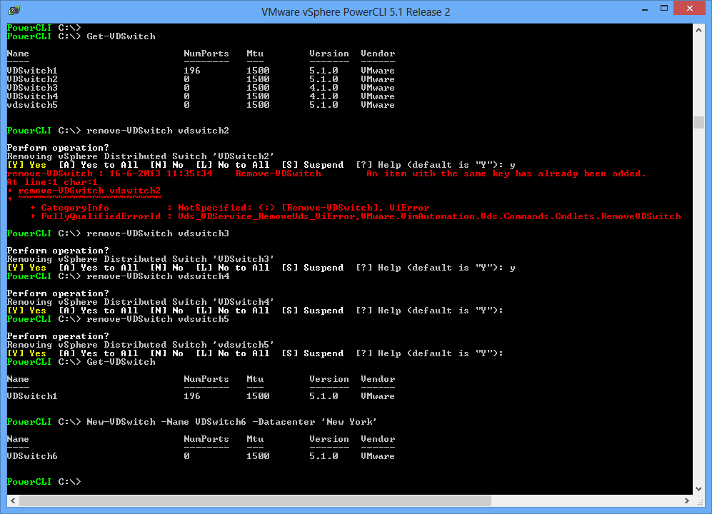

    Today I had the same error with the first Remove-VDSwitch command in my PowerCLI session. When I tried to create a new VDSwitch it went without an error. Maybe you are right and will this happen only once in a session.

    Very interesting, and thanks again!  I did some more testing, and turns out I get the same error even using Set-VM and just simply setting the "Notes" property wtih -RunAsync.  Again, this is ONLY the first time per session.
    I'm going to pass this news along to the tech assigned to the SR I have opened.  Hopefully a resolution can be found soon.  Otherwise I'm just going to do what I consider "sloppy code" and set something basic once to safely capture the error on the first trip for now.
