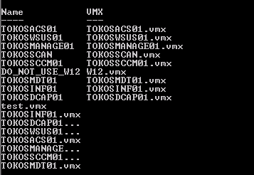

    Posted Aug 17, 2018 08:19 AM
    sorry that also did not work.

  • 12.  RE: finding .vmx file using powercli
    Posted Aug 17, 2018 08:47 AM
    so Get-ChildItem -Path TgtDS: -Filter *.vmx -Recurse     gave test.vmx also which is not given by the  $unregistered in updated script.

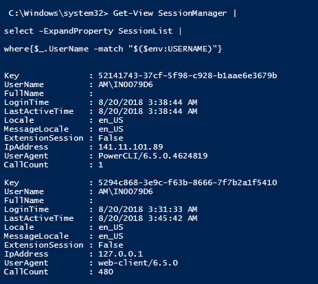

  • 17.  RE: finding .vmx file using powercli
    Posted Aug 17, 2018 11:44 AM
    Try like this (but this will only work if you logon with an AD account, not with a SSO account.
    Get-View SessionManager |
    select -ExpandProperty SessionList |
    where{$_.UserName -match "$($env:USERNAME)"}
  • 18.  RE: finding .vmx file using powercli
    Posted Aug 17, 2018 12:55 PM
    Thanks luc .i will be checking both shortly.
  • 19.  RE: finding .vmx file using powercli
    Posted Aug 20, 2018 03:52 AM
    i got following .and iam running this session from 141.11.101.89    also i see same output again from 127.0.0.1 .is this normal output.???
    also iam not sure what is callcount.
  • 20.  RE: finding .vmx file using powercli
    Posted Aug 20, 2018 04:44 AM
    That seems to be the Web Client you have open..
    I see the same, no idea why this shows the localhost.
