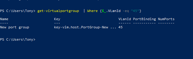

    Posted Dec 19, 2019 03:39 PM
    get-virtualportgroup  | Where {$_.VLanId -eq "256"}
    256 is the VLAN ID

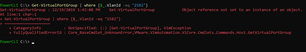

  • 3.  RE: Find VLAN Name from VLAN ID
    Posted Dec 19, 2019 04:02 PM
    When I ran that command, I got a "Get-VirtualPortGroup  Object reference not set to an instance of an object" error.
    I also got the following output:
    "WARNING: The output of the command produced distributed virtual portgroup objects. This behavior is obsolete and may change in the future. To retrieve distributed portgroups, use Get-VDPortgroup cmdlet in the VDS component. To retrieve standard portgroups, use -Standard."

    Posted Dec 19, 2019 05:20 PM
    just tested and it definitely works for me... can you run Get-PowerCLIVersion and let us know the version you're running? attach a screenshot of your error

    Posted Dec 19, 2019 06:53 PM
    Ah youre running an older version, im on:
    PowerCLI Version
       VMware PowerCLI 11.5.0 build 14912921
    try
    get-vdportgroup | select Name, VlanConfiguration

    Posted Dec 20, 2019 08:58 AM
    While I definitely encourage you to upgrade your PowerCLI version, that is not the real issue at hand.
    The Get-VirtualGroup cmdlet has been marked "deprecated" since quite some time.
    The real issue is that the VlanIds for a VSS and a VDS are not obtained in the same way.
    Have a look for example at Re: List Portgroups with Private VLANS
    You could eventually use that script, and pipe the result to a Where-clause that filters on the VlanId property.
