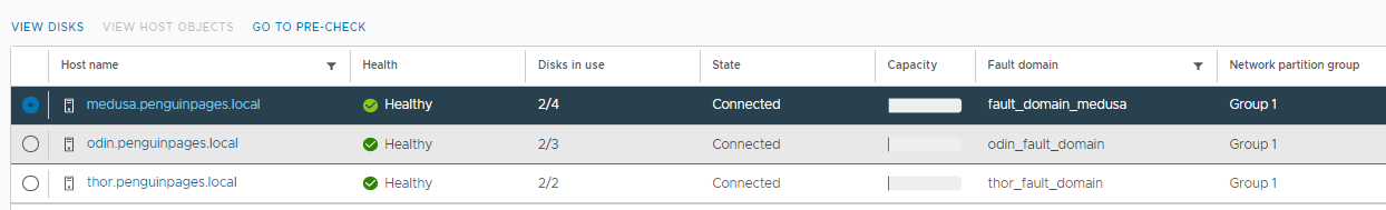

    Posted Feb 14, 2022 08:06 PM
    I noted RAID .. but it is JBOD controller.
    But what I did find .. is that if I create  VMFS file system.. copy over 10GB or so (maybe just partition was sufficient but I did a copy to test health of disk)   I could then delete the datastore... and then vSAN would allow consumption.
    vSAN back to ... well. next step to setup again.
