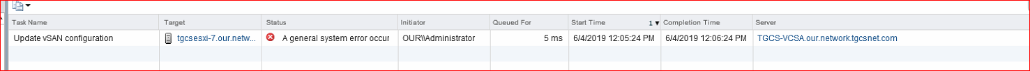

    VMWare 6.5
    I have two vCenters both running 6.5
    I have 9 ESXI hosts all running 6.5 and up to date will all patches.
    Trying to implement VSAN on both ESXI Hosts.
    1. Created a Datacenter on both vCenters.
    2. Add VSAN to my VMkernal on each ESXI host.
    I had a VMkernal already defined the same name on all 9 hosts.
    I started to add VSAN to each one and on several it added but a few it did not.
    After a while I tried again and they added the VSAN
    I have one ESXI 6.5 host that will not add it.
    A General System error occurred     any ideas?
    Thank you

    The command failed and all hosts are at same version as you can see below.  Any other command to try?
    [root@TGCSESXI-7:~] esxcli vsan network ip add -i list
    Unable to complete Sysinfo operation.  Please see the VMkernel log file for more details.: Sysinfo error: Not foundSee VMkernel log for details.

    Update   I tried this     VMK3 is the interface that I am trying to add VSAN to
    [root@TGCSESXI-7:~] esxcli network ip interface tag get -i vmk0
       Tags: Management
    [root@TGCSESXI-7:~] esxcli network ip interface tag get -i vmk1
       Tags:
    [root@TGCSESXI-7:~] esxcli network ip interface tag get -i vmk2
       Tags: VMotion
    [root@TGCSESXI-7:~] esxcli network ip interface tag get -i vmk3
       Tags:
    So then I ran this
    [root@TGCSESXI-7:~] esxcli network ip interface tag add -i vmk3 -t VSAN
       Tags: VSAN
    [root@TGCSESXI-7:~]
    Now it has the Tag but when I look on vcenter the vmkernal still does not show the VSAN
    Thoughts
