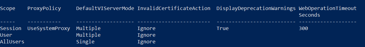

    What does Get-PowerCLIConfiguration return?

    Please find the output

    That seems to be ok.
