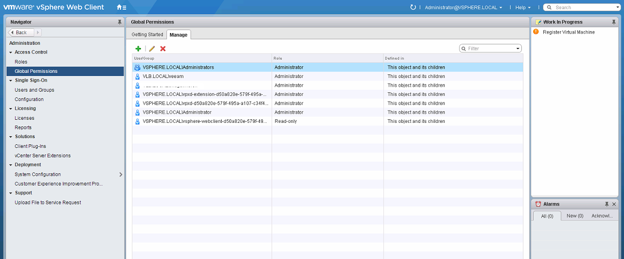

    What account exactly are you using? And can you show a screenshot inside vCenter where it lists its permission?
  • 5.  RE: Error trying to perform backup. Failed to open VDDK disk
    Posted Feb 04, 2018 02:44 PM
    As I said before. I am using the account administrator@vsphere.local, vCenter was added in Veeam with this account.
    Right at the beginning, I created a Veeam account with Administrator permission, it did not work, so I started to use the account administrator@vsphere.local
    I am sending the image with users and feeds permissions.
    I wait and thanks !

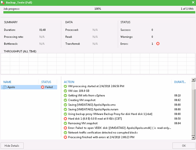

    Yes, the snapshot occurs normally, there is also enough space in the Veeam Repository, Veeam Backup and Veeam Proxy are on the same machine, it is a Dell physical server with 48GB of RAM.
    I am sending two more images with a test I just made, trying to backup a single virtual machine.

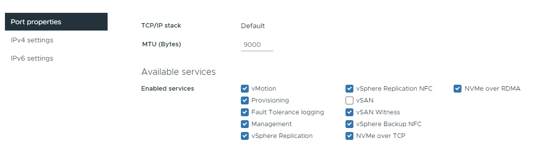

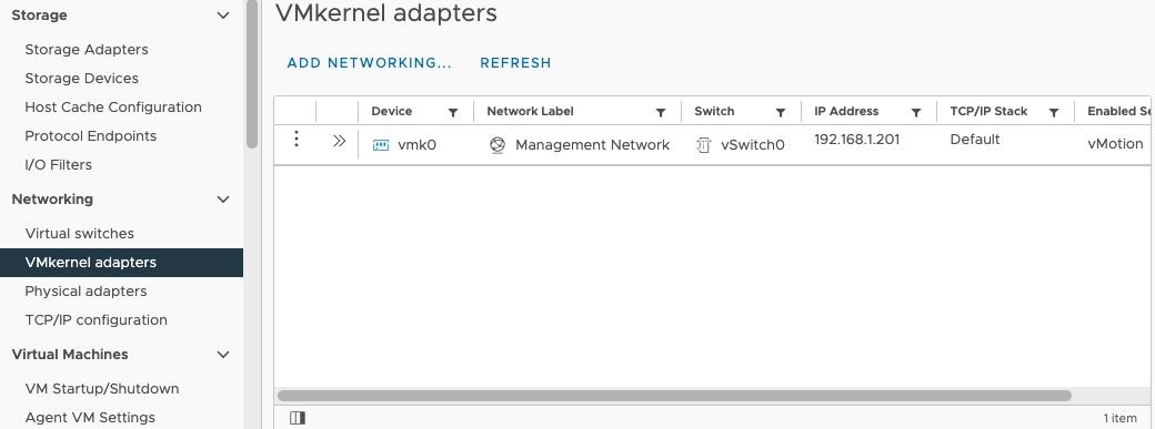

    I had a similar error. This is a new setup. And the solution for me was to enable vmkernal services on the network adapter reachable from veeam server. On every host. I think it is either vMotion or Provision weeam use. Be careful when changing in production:

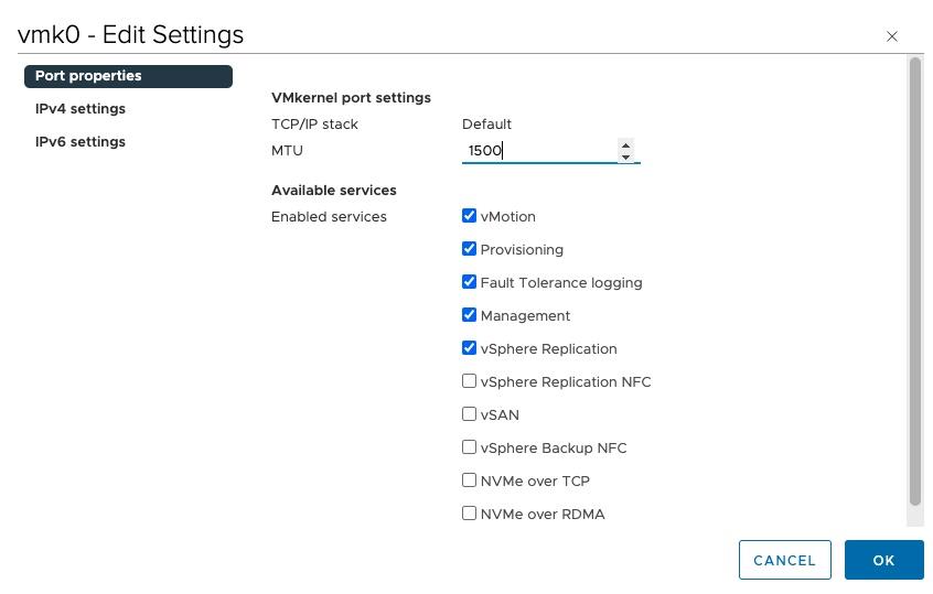

    Just following up on this, as I have the exact same problem, and it was a very easy fix - I spent an age checking NTP servers, password authentication, but it was all down to bad networking on the VSphere envoirnment, where I had adding network configuration for VMotion between the hosts, on a separate network. So the solution - this is a demolab - was to remove any other networks, and leave the system with one network, and enable VMotion on that network - so I have a flat network configuration which means that all the protocols, are on a simlar network which Veeam can see. ref details below:
