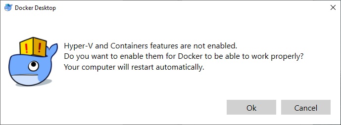

    Docker runs natively on most Linux distributions, but for Windows one would need execute some additional steps to enable Hyper-V.
    Docker Desktop for Windows requires Microsoft Windows 10 Professional or Enterprise 64-bit.
    If you have that version make sure you install it and then agree to enable Hyper-V:
    For previous versions get Docker Toolbox. The Docker team has provided a very extensive manual on how to set up Docker Toolbox for Windows.
