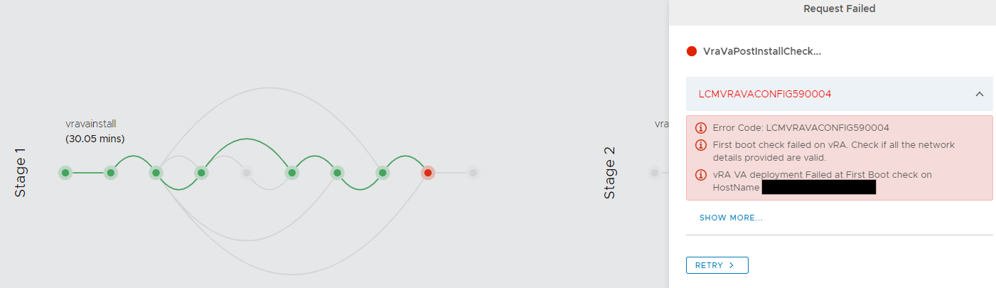

    Hi All,
    I've see this error throughout my searches and only a couple within the community but I still haven't been able to find a solution.
    During a re-installation of vRealize via the Easy Installer, I've been having this
    error: LCMVRAVACONFIG590004
    com.vmware.vrealize.lcm.common.exception.EngineException: vRA VA deployment Failed at First Boot check on HostName ci-0027743.evgroup.com at com.vmware.vrealize.lcm.plugin.core.vra80.task.VraVaPostInstallCheckTask.execute(VraVaPostInstallCheckTask.java:104)
    at com.vmware.vrealize.lcm.automata.core.TaskThread.run(TaskThread.java:45)
    at java.util.concurrent.ThreadPoolExecutor.runWorker(ThreadPoolExecutor.java:1149)
    at java.util.concurrent.ThreadPoolExecutor$Worker.run(ThreadPoolExecutor.java:624)
    at java.lang.Thread.run(Thread.java:748)
