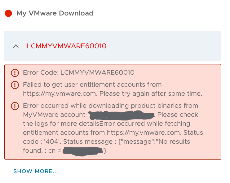

  • 13.  RE: Error Downloading Product Binaries from MyVMware Account
    Posted Aug 12, 2021 07:00 PM
    I just tested with another MyVMware account which is not entitled for any vRealize products. While vRLCM is able to validate the account when I added it, attempting to download any binaries gives a 404 response code and a message about not being able to obtain user entitlements:
    That's more in line with the response I expected from an account which wasn't sufficiently entitled. It seems likely that the server would tell the client why it's refusing the request rather than just aborting the connection with no explanation.
