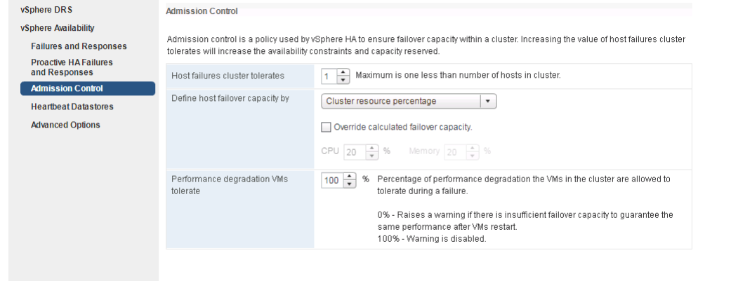

    hi Luc,
    Iam trying to convert following into powercli to enable drs ,HA and admision control .
    while DRS and HA is quite straitforward with set-cluster command but iam finding little confusion configuring Admission control .
    i think this is also using set-cluster but how to decide what policy is best suited .not entirely powercli question but if could suggest something on it .

    I'm afraid that those settings can not be done through a cmdlet, you will have to use the ReconfigureCluster API method.
    Something like this for example
    $clusterName = "MyCluster"
    $cluster = Get-Cluster -Name $clusterName
    # HA
    $spec = New-Object VMware.Vim.ClusterConfigSpec
    $spec.DasConfig = New-Object VMware.Vim.ClusterDasConfigInfo
    # HA Enabled
    $spec.DasConfig.Enabled = $true
    # HA - Admission control
    $spec.DasConfig.AdmissionControlEnabled = $true
    # III - Resource percentage
    $spec.DasConfig.AdmissionControlPolicy = New-Object VMware.Vim.ClusterFailoverResourcesAdmissionControlPolicy
    $spec.DasConfig.AdmissionControlPolicy.FailoverLevel = 1
    $spec.DasConfig.AdmissionControlPolicy.ResourceReductionToToleratePercent = 100
    # IIIa - Auto sizes
    $spec.DasConfig.AdmissionControlPolicy.AutoComputePercentages = $true
    $modify = $true
    $cluster.ExtensionData.ReconfigureCluster($spec,$modify)
  • 3.  RE: enabling cluster properties through powercli
    Posted Nov 21, 2018 10:18 AM
    There have been many blog posts, books and VMworld sessions on how to select the optimal admission policy for your environment.
    In the end, it all comes down to what you want to cover, and what kind of resources you have at your disposal.
    A short, handy start is the Best Practices for Admission Control section in the vSphere Availability document.
    But like I said, you will have to evaluate for what you want to cover and what HW you have available.

    Hi Luc ,
    good morning ,
    below is one of the clusters where no resrvation (cpu,mem) on vms. code is also attched(little modified to what we had yesterday)
    could you suggest appropriate code for green lines in screenshot(whether commanlet or api).

    If you want those settings, then you can make do with the cmdlet, no need for the API.
    Set-Cluster -Cluster $cluster -HAEnabled $true -HAAdmissionControlEnabled $true -HAFailoverLevel 1 -Confirm:$false
  • 10.  RE: enabling cluster properties through powercli
    Posted Nov 29, 2018 07:26 AM
    thanks .once this is set and since there is no reservation configured .slot size will be automatically taken by some algorithm .is that correct ??
  • 11.  RE: enabling cluster properties through powercli
    Posted Nov 29, 2018 07:32 AM
    Correct
