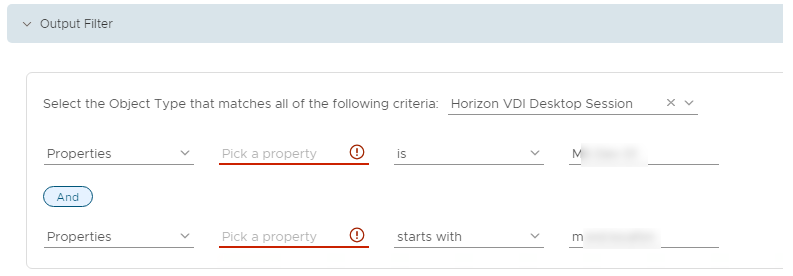

    We did some performance tests and I'm now working on reporting the outcomes. I have a dashboard that contains various widgets.

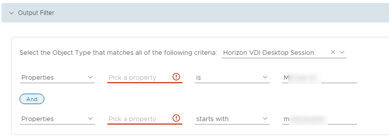

    In one of my widgets, which is a metric chart, I am using an Output Filter to filter out some data.
    After doing a save I get the expected results but each time I attempt to edit the widget the filter is broken!
    I've tried Chrome and Firefox but the situation is the same. It's quite annoying so any help greatly appreciated
    Cheers,
    Greg

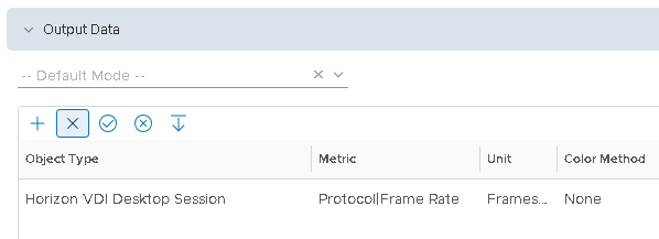

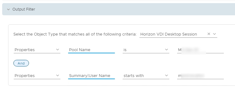

    Thanks for getting back to me Below are screenshots from editing the Widget. The Widget is one of many on this Dashboard.
    As you can see here the output filter property is missing
    After entering the required pool and the start of the username, domain.local\user00, I can save the Widget and see the data.
    When I next edit the widget I have to re-enter the data!

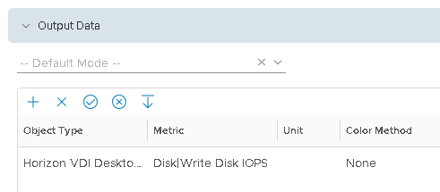

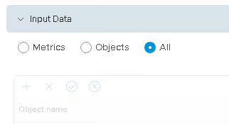

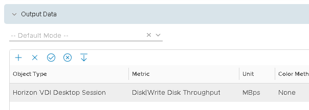

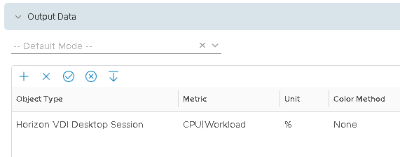

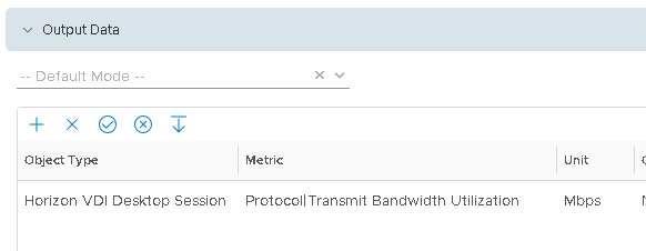

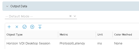

    I get the same issue with these Widgets, which are all configured with an identical output filter...
    But these ones, which are also configured with an identical output filter, do not have the issue!
