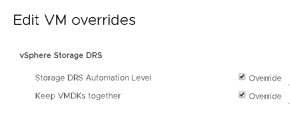

    I need some help writing a quick powercli script that works with 6.5/6.7 to disable the vm overrides.  I want to uncheck the following two and use the cluster settings.
    Thanks for the help!

    Thanks for the link.  Yes, I did try scouring the web to do similar and can't find what I need.  It used to work with 6.0 and now it does not.  It seems the 3 argument is an issue with 6.5/6.7.  Some code unchecks one of the two options and not the other and I struggle to truly understand the spec new vs edit.  I've tried every combo I can think of and am coming up short.
    exception calling "ConfigureStorageDrsForPod" with "3" argument(s): "
    Required parameter pod is missing
    while parsing call information for method ConfigureStorageDrsForPod_Task
    Thanks,
    Kelly
