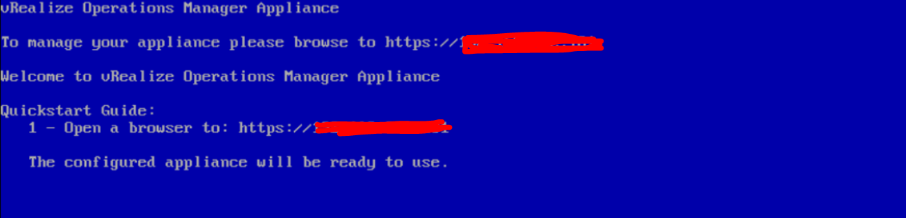

    I am deploying vrealize operations manager 8.4. The ova display ends well and when I turn on the vm. Indicates an error with the network settings.
    The ova finishes starting completely and the blue screen appears with the assigned IP. However, it does not respond to ping.

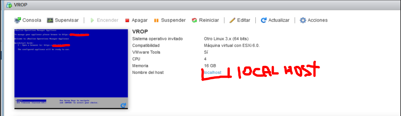

    From the vcenter, I select the vm of vrop and in the summary tab it indicates in the DNS localhost.
    In addition, the records are also created in the DNS server with the IP assigned to the vrop vm.
    also configure the etc / host of my domain controller and put the ip of the vrop. However, the problem continues.
    The deployment I am doing in a vCenter 6.7 and ESXi 6.7
    Annex evidence.

    The problem was that it was detecting a local DNS 127.0.0.1. I proceeded to remove this ip 127.0.0.1 from the etc / host file on my domain controller. And then if it detected my correct DNS.
