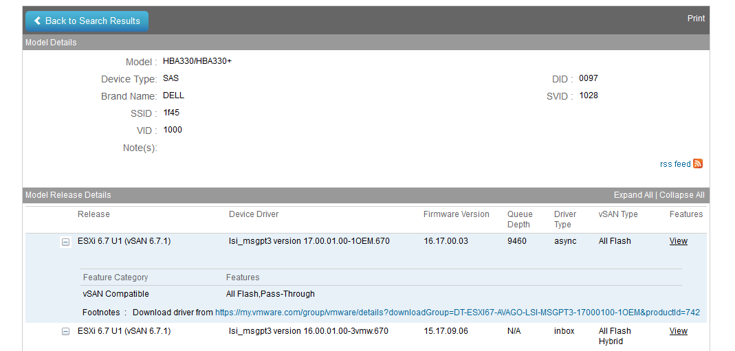

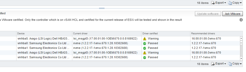

    Hi All - I have a warning on my Health Check that references a Controller Driver compatibility error
    I believe the error to be wrong as I am running the fully certified driver downloaded directly from the HCL link on VMware website, see below
    I suspect that its just not updated on the Health Check yet. I am running the latest version of the HCL Database downloaded via vCenter
    Does anyone know when this Heath Check Database might be updated as I hate seeing warning errors on my vSAN?

    I have confirmed the VID , DID , SVID , SSID are correct for my HBA
    You will see it still recommends the older driver as the driver to use but obvious I would prefer to use the most recent HCL compliant driver.

    Hello Evan55​,
    It is referencing lsi_msgpt3 16.00.01.00-3vmw.670 as recommended driver so likely you are still using Firmware version 15.17.x.x - if you want to use lsi_msgpt3 17.00.01.00-1OEM.670 then update the firmware to the matching version (16.17.00.03). If you are using firmware version 16.17.00.03 please open an support request with us at GSS to have a further look.

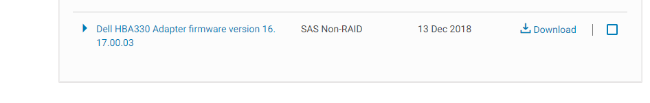

    It seems Dell updated their drivers page the day after I posted this thread.
    I updated my vSAN with this firmware and all is now good. Thank you for your assistance.
