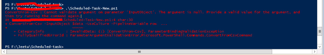

    Hi Lucd,    I am getting this error while running the script

    That was from a test I did.
    I corrected the code above.

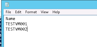

    Hi Lucd,
    I am trying to run the script row by row using ISE. I did see an error while running the Import-csv command as below. please could you check and help me with that.
    I have this data in the CSV file.
  • 6.  RE: Create Scheduled task for 400 VMs on vmware
    Posted Jul 14, 2021 08:13 AM
    You can't run that line by line, there is a pipeline symbol at the end of the line.

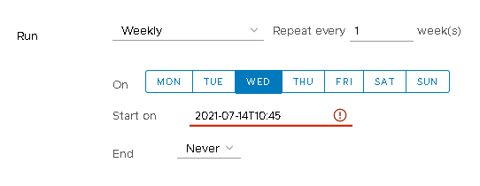

    thanks for the script, I did ran it and its working. but when I check the schedule task the time is not set to what I want. It still showing the current date and time. I wanted to set BST time of Every Wednesday 05:00 AM . Please could you help with that.
  • 8.  RE: Create Scheduled task for 400 VMs on vmware
    Posted Jul 14, 2021 11:17 AM
    Not sure what exactly you did but for me this is running at 5 am every wednesday.

    Hi Lucd
    The time zone I have in my environment is (UTC+00:00) Dublin, Edinburgh, Lisbon, London so is that the issue its not showing the correct time ?
  • 10.  RE: Create Scheduled task for 400 VMs on vmware
    Posted Jul 14, 2021 01:19 PM
    What is this returning for you?
    (Get-Date -Hour 5).ToUniversalTime().Hour

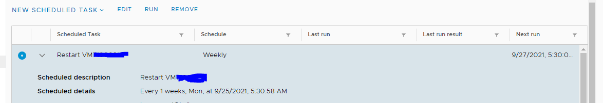

    I am trying to put the minutes also in this script but seems its not working. I did put like below and wanted to scheduled the task at 5.30 AM but its not working, its still create the task for 5 AM. Any thoughts pls
    $spec.Scheduler.Hour = (Get-Date -Hour 5 -Minute 30).ToUniversalTime().Hour

    Hi Luc,
    I got it . I did added another line with -Minute and Its creating the schedule task with minutes too. Is there any way to modify the existing task , like the date and time which are creating using below code. Please can you help .

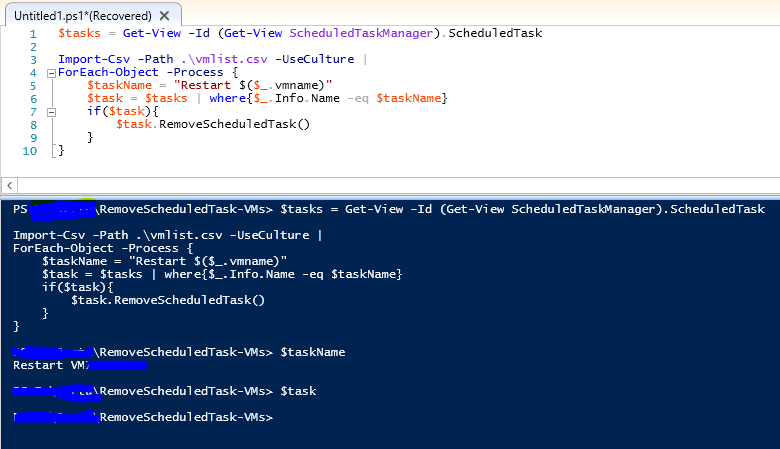

    I try to run the code it did ran but did nothing, I Try to get the output of $taskName = "Restart $($_.vmname)" but it did return only with  "Restart" name not with "Restart VMName"
  • 25.  RE: Create Scheduled task for 400 VMs on vmware
    Posted Sep 26, 2021 09:49 AM
    Then the column in your CSV is probably not named 'vmname'.
    What is in your CSV?

    Sorry for confusion. I can see its returning the correct task name. but the task scheduled is not getting deleted. below is the script screen shot.
  • 27.  RE: Create Scheduled task for 400 VMs on vmware
    Posted Sep 26, 2021 03:28 PM
    Hi Luc,
    I am really sorry, Its all my mistake I was connected to multiple vmcenter servers hence the script was not able to find the VMs to delete the scheduled task. I did connected the the correct VC and now script is working fine.
    Again Thank you very much for your help. Appreciate it mate!!! Kudos to you!
