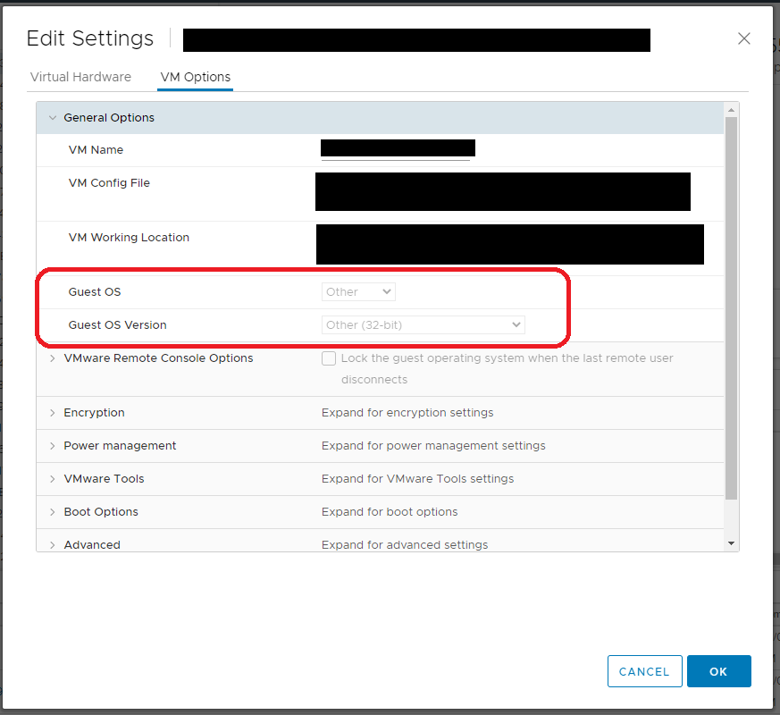

    Hello
    When Guest OS is set to "Other" on a Windows VM the PowerCLI command "Copy-VMGuestFile" fails with error 500.
    When changing the Guest OS type to Windows the command works.
    On a Linux VM it does work when it's "Other".
    Is there a way to understand why is it failing or how to solve it without changing the guest OS type?
    Because changing it requires a shutdown of the VM.
    Any advise would be appreciated.
    Thanks.

    That at least shows that the correct methods are called.
    I suspect that the VMware Tools, based on the GuestId, makes assumptions about the filesystem and the path separator.
    Perhaps there is something in the vpxd log (but you might have to set the level to 'verbose' first)
