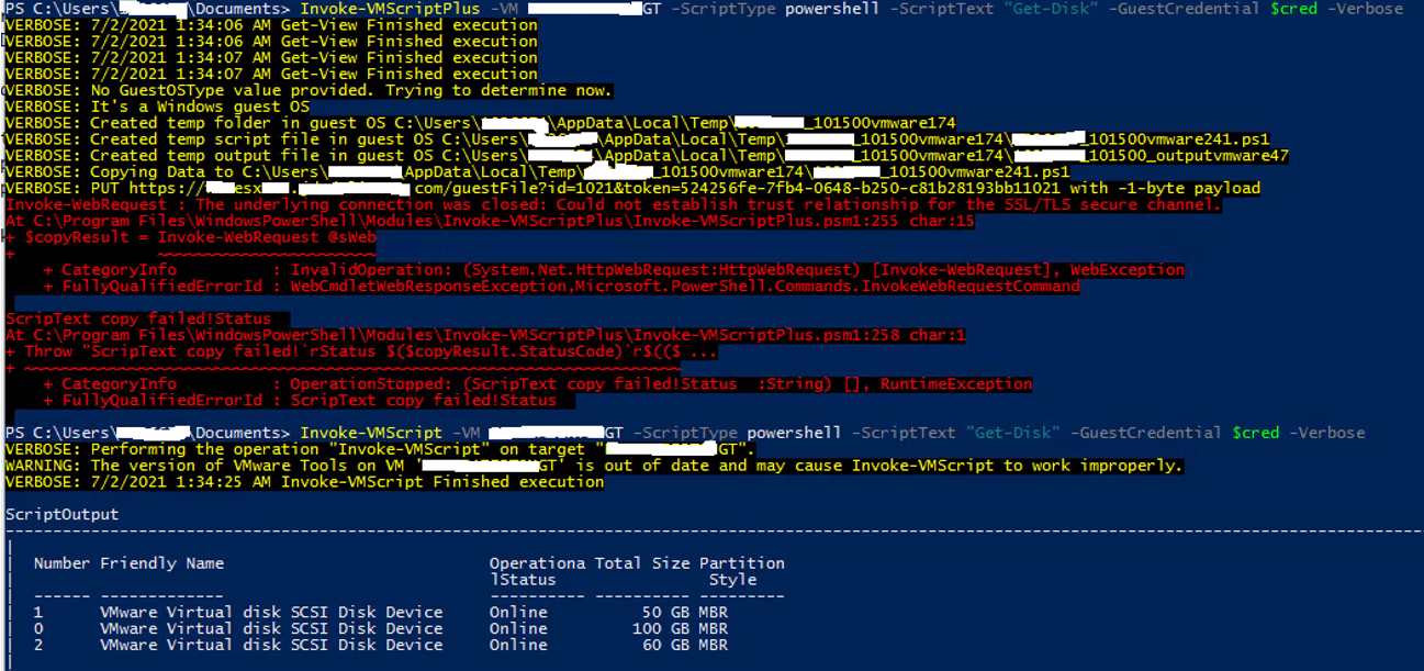

    Can you try the same with my Invoke-VMScriptPlus with the Verbose option?
    That might give more info on what the problem is.
  • 9.  RE: Copy-vmguestfile. An error occurred while sending the request
    Posted Jul 02, 2021 06:44 AM
    HI Luc,
    Attached is the error details with verbose switch in the not working set of server. Where the invoke-vmscript also doesnt work.
    And below screenshot pasted is from the working set of server where invoke-vmscript/copy-vmguestfile is working but NOT sure why Invoke-vmscriptplus is giving some error.
    Thanks

    I used the latest code & now the error is different.
    Attached is the screenshot of the error.
  • 16.  RE: Copy-vmguestfile. An error occurred while sending the request
    Posted Jul 02, 2021 10:17 AM
    Looks like I had another bug (type test) in there, should be corrected now.
  • 17.  RE: Copy-vmguestfile. An error occurred while sending the request
    Posted Jul 02, 2021 10:41 AM
    Tried with the new code and the error what i am getting is attached.
  • 18.  RE: Copy-vmguestfile. An error occurred while sending the request
    Posted Jul 02, 2021 10:52 AM
    Ok, now we are getting somewhere.
    The transfer of the code to target VM seems to fail for whatever reason.
    Let's first check if the URI makes sense.
    Can you add after line 239 (the one with Write-Verbose) a line with Format-Custom.
    That should show the URI that is actually used.
          Write-Verbose -Message "Copying $($PSCmdlet.ParameterSetName) to $File"
          $sWeb | Format-Custom    # <-- add this line
  • 19.  RE: Copy-vmguestfile. An error occurred while sending the request
    Posted Jul 02, 2021 11:08 AM
    Hi Luc,
    Attached is the error with the new code.
    The uri value is the esxi fqdn name where the destination VM is hosted.
  • 20.  RE: Copy-vmguestfile. An error occurred while sending the request
