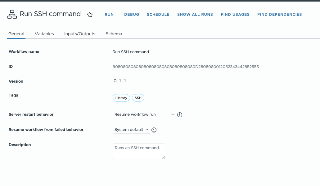

You don't need to pass anything. Just run it. It will execute a default "uptime" command on the remote server and return the output. If that works, it will confirm the vRO is able to "talk" with the remote server. Means there are no firewalls, etc. between them :)

Thanks, I saw the Built in one but struggled with how to pass it the inputProperties I need and the password etc, so I extracted from it the lines that make the SSH connection. I'll have another play with it today.
Do I have to create an additional workflow to extract the inputProperties etc in to variables, then create a master workflow that contains my workflow and the built in SSH one - then link the Input and Output Variables between them? Or is there a more straight forward way to just use teh Built in SSH one?
I'm also going to try Hard Coding another server in to my script to see if the code can SSH to anything at all

Hi Stuart,
There's a built-in workflow called "Run SSH command." Could you please manually deploy your Linux server and run that workflow against it? This will confirm that vRO can SSH into the server in general.
