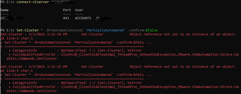

    Posted May 03, 2022 07:28 PM
    Thanks for the reply. I'm on Powercli 12.0 Build 15947286 and this is against a VC on 7.0.3d
    This is mostly what gets returned, specifically for the first two:
    PS C:\> Set-Cluster * -DrsAutomationLevel 'PartiallyAutomated' -confirm:$false
    Set-Cluster : 5/3/2022 2:26:29 PM Set-Cluster Object reference not set to an instance of an object.
    At line:1 char:1
    + Set-Cluster * -DrsAutomationLevel 'PartiallyAutomated' -confirm:$fals ...
    + CategoryInfo : NotSpecified: (:) [Set-Cluster], ViError
    + FullyQualifiedErrorId : Client20_ClientSideTaskImpl_ThreadProc_UnhandledException,VMware.VimAutomation.ViCore.Cm
    dlets.Commands.SetCluster
    At line:1 char:1

    Posted May 03, 2022 08:15 PM
    Its a brand new session.  I attached a screenshot from connect-viserver to the command in question

  • 10.  RE: Change Cluster DRS Automation Level
    Posted May 03, 2022 09:31 PM
    There seems to be a mix of 12.0 and 12.6 in different folders.
    I would suggest removing all those PowerCLI-related folders in all 3 locations, and then, after a stop/start, do a fresh install
    See Welcome PowerCLI to the PowerShell Gallery – Install Process Updates
  • 11.  RE: Change Cluster DRS Automation Level
    Posted May 05, 2022 12:59 PM
    Update, I removed everything, manually downloaded and installed again per the guide, same result.
    Next, I removed once more, took my laptop off my company network, ran the install and now its working.  So it you were right, it was my installation after all.  Thanks for the help!
    John
