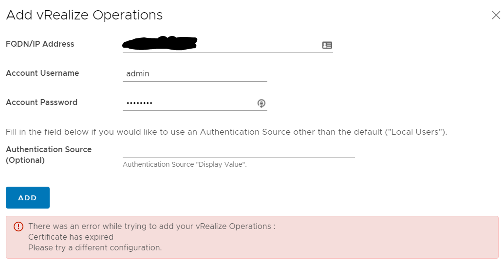

    I've been trying to connect my vROps to Skyline.  I'm running vROps 8.1, and Skyline 2.5.
    The error I am receiving is that a certificate is expired.  However, the message doesn't tell me what certificate.  The certificates for Skyline and vROps are self-signed and the earliest that either expires is 2023.  I have confirmed that I am using the correct admin password for vROps (I also tried the admin password for Skyline).
    I have tried using both the IP and the FQDN, but neither seems to work (same message).
    Am I required to use actual certificates on these servers now?  They are only accessible from within my data center, so I don't really want to spend the money on that.
    Any suggestions?

    Adding on a bit more.
    Using this command from the Skyline CLI - "curl -v https://vropsfqdn:443" - I am given a message that curl failed to verify the legitimacy of the server, and therefore could not connect.  This leads me back to needing to put a cert on the vROps server.  Seems odd, since I didn't need a cert to connect Skyline to my vCenter, but I will try this with my company wildcard.

    Hello RWijbrandus,
    You will need to use the same FQDN/IP address as the subject name or subject alternate name of the SSL cert.
    For example, we should use the same address the cert is issued to address the endpoint. A difference would fail validation.
    The 'Certificate has expired' error implies one of the services may be using an expired certificate.

    Posted Jul 28, 2020 07:24 PM
    I thought the same at first.  I checked my certificates, though.  Unless I need to check somewhere else, they are all current.
    Skyline vApp expires 2023.
    vROps expires 2025.
    vCenter vApp expires 2026.
    Sure, these are self-signed, but I haven't seen anywhere that requires me to put SSL certs on.

    Hello RWijbrandus
    We will need to look into the logs to investigate further. Please share your account and contact details on the following form:
