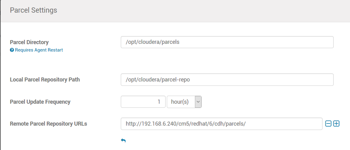

              local cloudera manager yum repository and parcel repository.Besides i installed the cloudera manager agent,deamon and oracle j2sdk in node template already. (after installing i removed the snapshot of node template and restarted the management server)
         Here is the problem that i encountered:

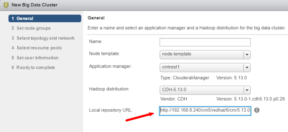

              when i try to create a big data cluster using cloudera manager as the application, i can see the cdh is just the right version that i put in my local parcel repository.

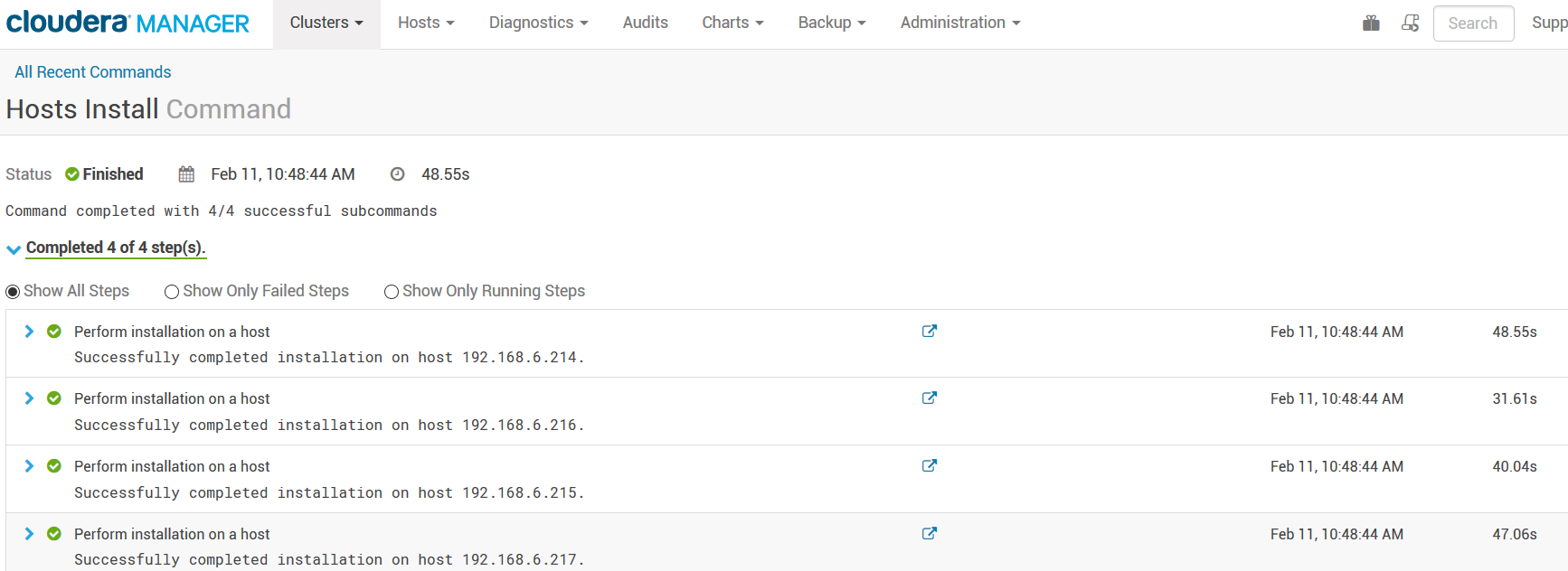

              when i finished the process of creating cluster,the vms are cloned with proper ip and hostname that i've wrote in unbound.conf in my dns server。the cloudera manager agent is started and
    the host agent installation is successful.

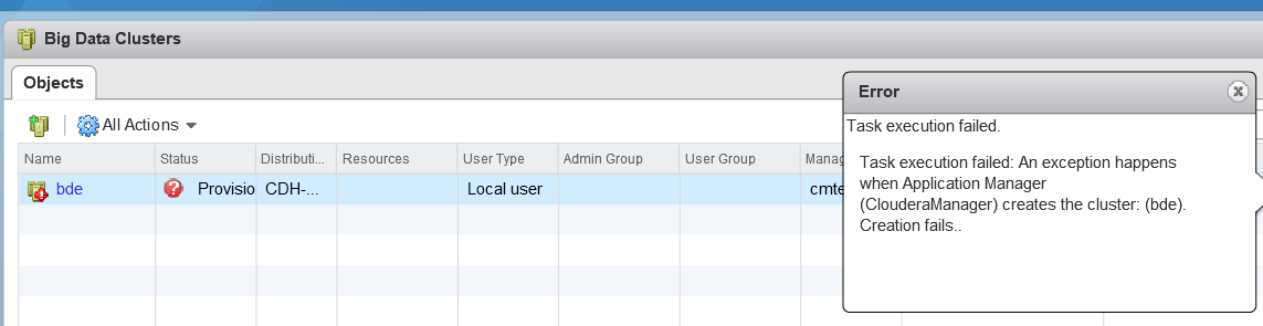

              but is ends up with the error:an exception happens when application manager creates the cluster.creation fails。
    it seems that the cloudera manager couldn't install the parcel in hosts.
    anyone khows why?
