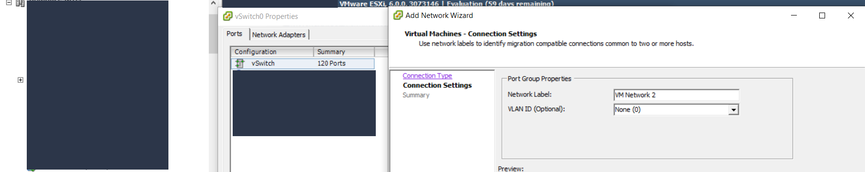

    Hi all.
    I have an esxi host 6.0.0 that I need to add a bunch of port/Vlan to it but they are a bunch , has any gone through the steps of adding this using PSCLI
    Instead of adding one by one import a text file
    Netowrk label             VLAN ID
    xxx.xxx.xxx.xxx                 01
    xxx.xxx.xxx.xxx                 02
    Thanks

    Ok, you want to add a number of Portgroups?
    That is quite straightforward.
    Does the switch already exist?
    From your screenshot it looks as if this is a VSS.
    Correct?
    In that case you could do something like this
    $esxName = 'MyEsx'
    $vssName = 'vSwitch1'
    $esx = Get-VMHost -Name $esxName
    $vss = Get-VirtualSwitch -Name $vssName -VMHost $esx
    Import-Csv -Path .\pg.csv |
    ForEach-Object -Process {
        New-VirtualPortGroup -VirtualSwitch $vss -Name $_.'Network Label' -VLanId $_.'VLAN ID'

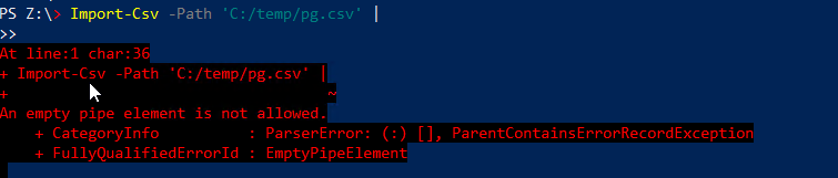

    When running your script  I get
    "an empty pipe element is not allow"
    Thanks
  • 5.  RE: Bulk Standard port adding
    Posted Mar 20, 2020 07:23 PM
    On which line?
    Can you show the complete error message?
    There is only 1 pipeline in that code, it's on the Import-Csv.
    Did you copy the pipeline symbol (|) at the end of that line?

    L.
    Right after the import-CSV
  • 7.  RE: Bulk Standard port adding
    Posted Mar 21, 2020 01:10 AM
    L.
    PG.CSV file = xxx.xxx.xxx.xxx,xx
    I had it  working with no error by doing the following
    Import-Csv -path .\pg.csv | Foreach-object {
    But after it run NO portgroup is added to switch0 or host
  • 8.  RE: Bulk Standard port adding
    Posted Mar 21, 2020 02:11 AM
    L.
    as always thank for your help, I was missing my header on my CSV therefore the loop was failing.
