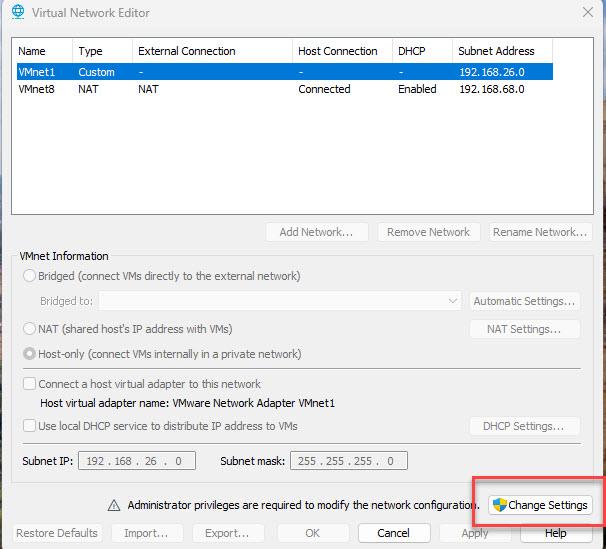

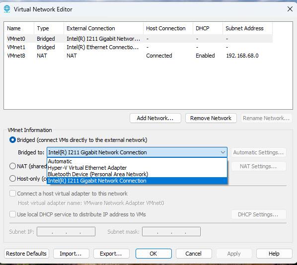

    So what I ended up having to do was go to Edit Menu --> Virtual Network Editor --> and change the settings for automatic bridged connection. I specified one NIC to use. I had to rebuild my VM afterward, but this fixed it.
