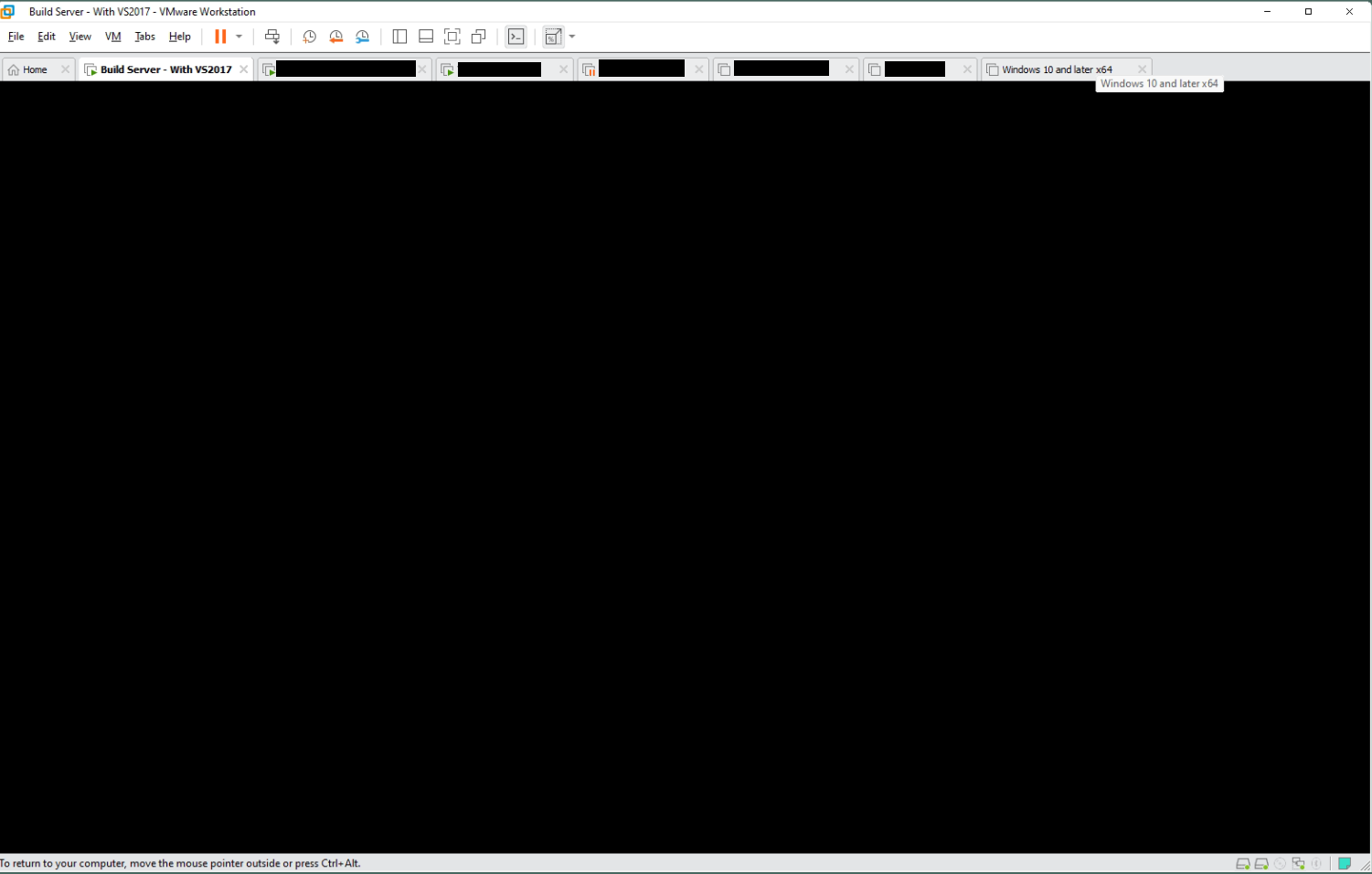

    II have successfully configured three VMs to auto-start upon reboot, with the VMware Autostart Service using the same account/login credentials.
    When using the VMware Workstation console, all I see is a blank screen, even though the guest is running fine:
    I can perform any of the commands (Restart Guest etc.) but there is still no display.
