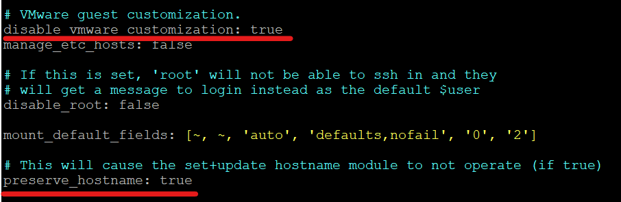

    In my config file, I also found these interesting options:
    After that, unfortunately, I have no other ideas

    in my cfg:
    disable_vmware_customization: true
    preserve_hostname: false

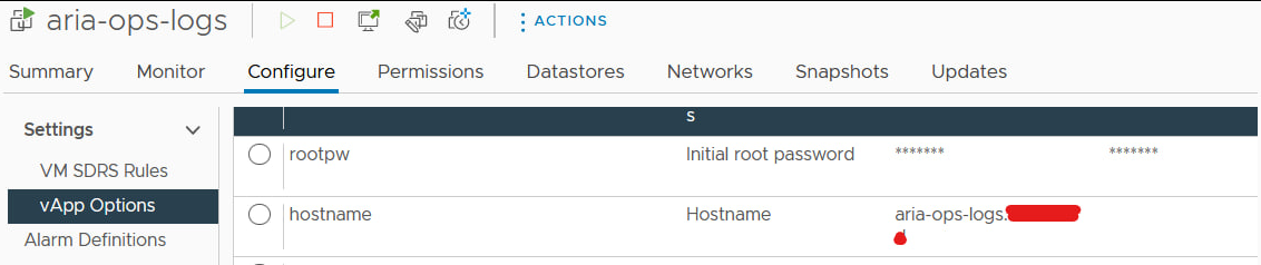

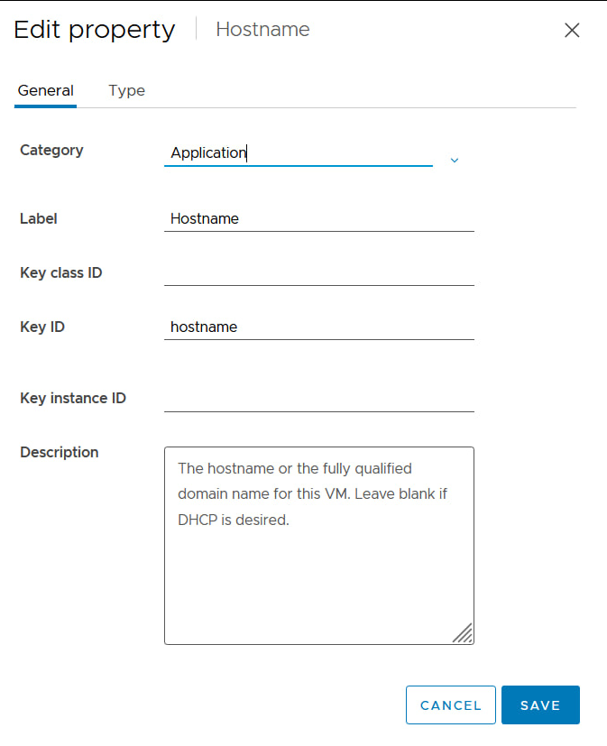

    So, you could try editing the vApp options from vCenter in guest OS mode:
    However, you might still need to make changes again from the operating system as in this KB: https://kb.vmware.com/s/article/87992
