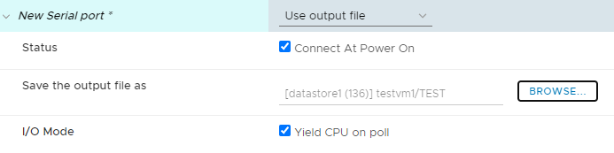

    And what if we select "Use Output File" and want to set local datastore or a storage from a datastore cluster where the vms have access to?
    How can we modify this script?
  • 8.  RE: adding serial port
    Posted Oct 19, 2023 02:36 PM
    In that case, the Backing should become a VirtualSerialPortFileBackingInfo instead of a VirtualSerialPortDeviceBackingInfo.
    That object will allow you to specify the Datastore and FileName properties
  • 9.  RE: adding serial port
    Posted Oct 19, 2023 04:08 PM
    So in this case will it be like below?
    $vmName = testvm1
    $dev = New-Object VMware.Vim.VirtualDeviceConfigSpec
    $dev.operation = "add"
    $dev.device = New-Object VMware.Vim.VirtualSerialPort
    $dev.device.key = -1
    $dev.device.backing = New-Object VMware.Vim.VirtualSerialPortFileBackingInfo
    $dev.device.backing.deviceName = '[datastore1 (136)] /testvm1/TEST'
    $dev.device.connectable = New-Object VMware.Vim.VirtualDeviceConnectInfo
    $dev.device.connectable.startConnected = $true
    $dev.device.connectable.allowGuestControl = $true
    $dev.device.connectable.connected = $true
    $dev.device.yieldOnPoll = $true
    $spec = New-Object VMware.Vim.VirtualMachineConfigSpec
    $spec.DeviceChange += $dev
    $vm = Get-VM -Name $vmName
    $vm.ExtensionData.ReconfigVM($spec)
  • 10.  RE: adding serial port
    Posted Oct 19, 2023 04:11 PM
    No, in this case, there is no DeviceName property, only a Datastore and FileName property.
  • 11.  RE: adding serial port
    Posted Oct 19, 2023 04:13 PM
    And how should I modify the script?
    $vmName = testvm1
    $filePath = "[datastore1 (136)] /testvm1/TEST.txt"
    $dev.device.backing.fileName = $filePath
  • 12.  RE: adding serial port
    Posted Oct 19, 2023 04:57 PM
    Yes, like that
