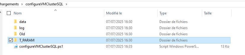

    Here is a script I had created for configuring a SQL cluster on Windows. It can be adapted to meet your requirements. Are you referring specifically to RDM disks?

    This PowerCLI script automates the management of Raw Device Mapping (RDM) disks in a VMware vSphere environment. It simplifies the RDM setup by attaching them to a primary VM and replicating the configuration across one or more secondary VMs.
    Main Features:
    1. Connects to the vCenter Server (using provided server, user, and password).
    2. Gracefully or forcefully powers off the target VMs depending on VMware Tools availability.
    3. Removes any existing RDM disks attached to SCSI controllers 1, 2, and 3.
    4. Creates three additional SCSI controllers (bus numbers 1 to 3) on each VM.
    5. Adds the specified physical RDMs to the primary VM, evenly distributed across the controllers.
    6. Clones the RDM configuration onto each secondary VM, matching controller and unit placement.
    7. Restarts all involved VMs after configuration is complete.

  • 4.  RE: Adding Existing Disk to the VM
    Posted Jul 07, 2025 10:46 AM
    I'm going on vacation soon, but if needed, I can help you modify the script to meet your requirements.
    In the directory containing the script, you will find three subdirectories:
    Data folder: contains the file listeRDM.txt
    log folder: used for writing log files
    T_PARAM folder: contains the files T_FUNCTIONS.ps1 and T_PARAM.ps1
    Below, you will find the content of the various files as well as the updated script. In the initial version I sent you, I had replaced the LogAndShow function with a simple Write-Host.
