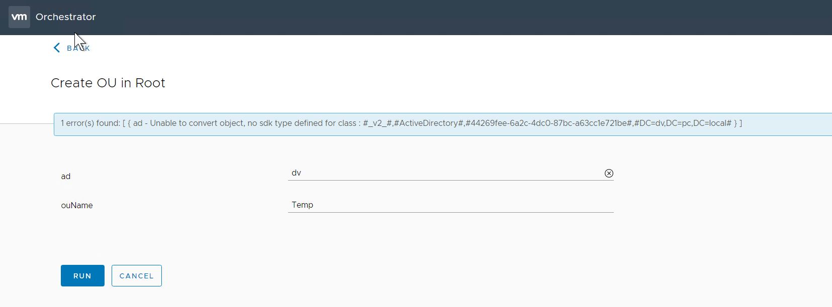

    Posted Dec 09, 2021 06:45 AM
    Its doesn't seem to be working in vRO 8.3 possibly due to AD plugin changes
