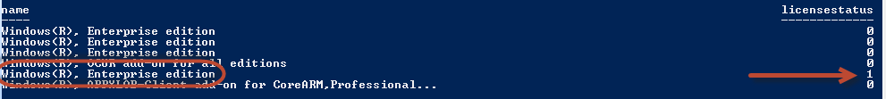

    You can do something like this
    $computer = Get-Content Env:ComputerName
    Get-WmiObject -Class SoftwareLicensingProduct -ComputerName $computer |
    select name,licensestatus
    One of the returned products should show a 1 in the licensestatus column
