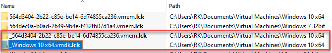

    Posted Oct 29, 2020 08:05 AM
    I have renamed the following files: _M29147.lck, _M64517.lck. But some folders are also present with the ".lck".  Should I delete these too?

  • 5.  RE: The process cannot access the file because another process has locked a portion of the file
    Posted Oct 29, 2020 10:09 AM
    Yes - as ROB said.
    Delete files and folders with lck.extension added.
  • 6.  RE: The process cannot access the file because another process has locked a portion of the file
    Posted Oct 29, 2020 11:34 AM
    Thanks buddy, I renamed all the files and folders and finally it worked.
