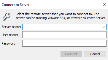

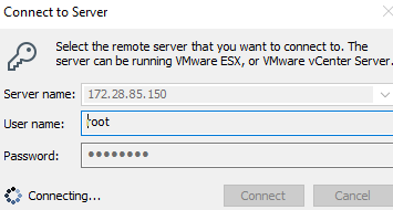

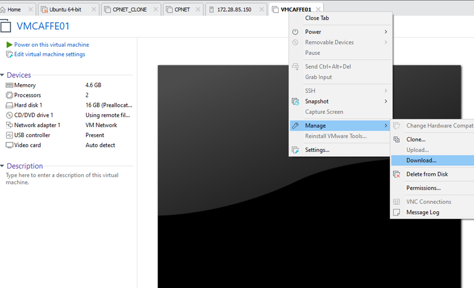

    On VMware workstation there is a command that allows you to copy a VM from an ESXi host to the OS where the Workstation is installed.
    You need to connect VMware Workstation to the ESXi host
    Enter your credentials
    The list of VMs on the ESXi server  appears, open the VM you are interested in and in the properties select Manage-> Download
