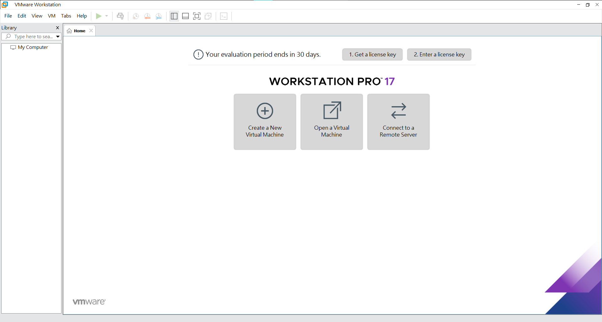

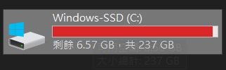

    I have a question,
    After I downloaded this app, I lost about 100GB of space from my storage.(I don't have any virtual machine)
    sorry for the noob question and bad grammar

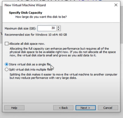

  • 4.  RE: Noob question about disk space
    Posted Mar 03, 2024 02:38 PM
    I remember that I clicked on this page a little before reinstallation
    (screenshot from network)
  • 5.  RE: Noob question about disk space
    Posted Mar 03, 2024 03:24 PM
    Sounds as if it might have been an accidental default config during install.
    It also looks like you might be close to a limit of how many VMs you could create based on the initial post images.  You may want to also consider options for external drive use for VMs with Workstation as you go forward.
  • 6.  RE: Noob question about disk space
    Posted Mar 03, 2024 03:54 PM
    So you not only installed Workstation, but created a virtual machine. The virtual machine’s disks will take up additional space on your disk as you install the operating system and use the virtual machine.
    The option to split virtual disks into multiple pieces typically provides the lowest use of disk space. The pieces start out small, and grow as you use disk space in the VM. Other types of virtual disks consume more disk space (with the option to fully allocate the disk consuming the entire amount of configured space).
    You may want to review the documentation to get a better understanding of how Workstation works.
