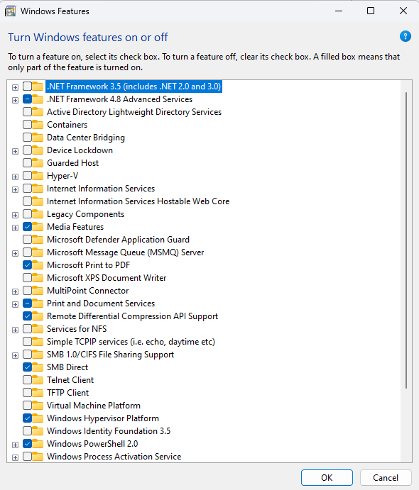

    My issue is not with Hyper-V
    It is not enabled on my machine.
  • 6.  RE: VM Workstation 15: The VM will not run if more than 1 processor or 1 core
    Posted Mar 27, 2024 01:38 PM
    Screenshot shows "Windows Hypervisor Platform" as enabled.
    Look at the thread I referred you to on how to completely remove Hyper-V and components that enable Hyper-V.
    Aside from Monitor Mode showing up as ULM, you can also check msinfo32.
    Kernel DMA Protection should be "Off"
    Virtualization-based security should be "Not enabled"
    Windows Defender Application Guard should not be "Enforced" or not appear at all in msinfo32.
