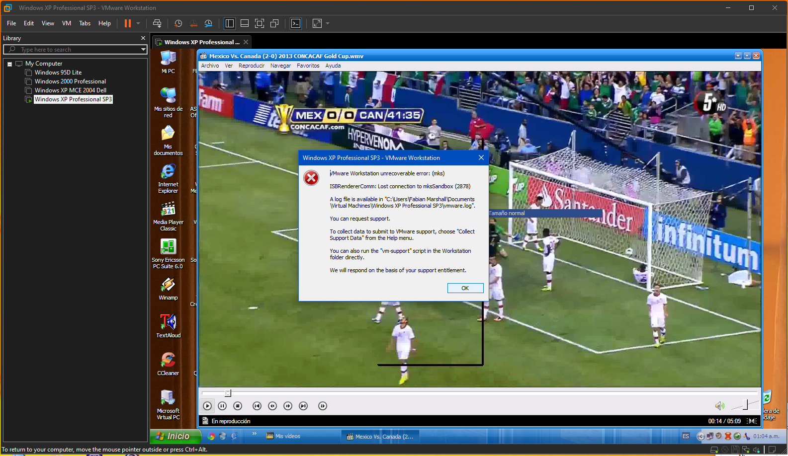

    Well, I'm having a small problem, which is directly linked to the Mks SandBox Process of vmware,
    it turns out that when Opening or Playing a Video with K Lite Codec Pack in Windows XP,
    the virtual machine becomes static, to the degree of not being able to do nothing and ends up Stop responding
    having to kill the VMX Process from the task manager.
    This Also Happens on Windows 7 vm, Windows Vista Vm.
    I know that the Problem is linked to VMware Sandbox since the process starts to Consume a lot of resources from my GPU.

    Posted Aug 02, 2023 07:18 AM
    I still have the same problem, it seems that it is a very serious issue, because I have returned to VMWare 16.2.5 and the problem persists.
    Attachment(s)
    log
    mksSandbox.log   67 KB 1 version
    log
    vmware.log   279 KB 1 version

    Best Answer
    Posted Mar 13, 2024 09:29 PM
    Well, that solution didn't really work for me. In the .vmx file I made the following modification
    mks.enable3d = "False"
    Now I can play videos without the Virtual Machine freezing.
