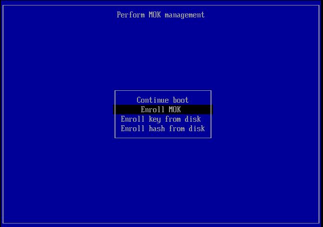

    I was able to locate the 'sign-file' command.  It is located in the following directory:  /usr/src/linux-5.3.18-lp152.41-obj/x86_64/default/scripts
    I entered the following commands:
    # /usr/src/linux-5.3.18-lp152.41-obj/x86_64/default/scripts/sign-file sha256 ./MOK.priv ./MOK.der $(modinfo -n vmmon)
    # /usr/src/linux-5.3.18-lp152.41-obj/x86_64/default/scripts/sign-file sha256 ./MOK.priv ./MOK.der $(modinfo -n vmnet)
    # mokutil --import MOK.der
    I rebooted my computer and had to authorize the modification to the kernel.  However, it still has the same problem.  Is there anything else that I need to do?
    Again thanks for all your help on this issue.

    # Shut down and rebooted Suse system, Answered the "Enroll MOK", Confirmed and entered password from previous step then rebooted.

    in my opensuse 15.4 I did:
    sudo openssl req -new -x509 -newkey rsa:2048 -keyout vmware.priv -outform DER -out vmware.der -nodes -days 36500 -subj "/CN=VMware/" -addext "extendedKeyUsage=codeSigning"
    sudo /lib/modules/$(uname -r)/build/scripts/sign-file sha256 ./vmware.priv ./vmware.der $(/sbin/modinfo -n vmmon)
    sudo /lib/modules/$(uname -r)/build/scripts/sign-file sha256 ./vmware.priv ./vmware.der $(/sbin/modinfo -n vmnet)
    sudo mokutil --import vmware.der
    restarted and enrolled modules in uefi bios automatically after confirming
    launched vmware and worked!

    Thank you so much  elNicolo !!! worked for me in OpenSUSE  15 SP5 EFI SECURE BOOT :
    OPENSUSE 15 SP5:
    password
    sudo reboot
    YES > password > REBOOT
