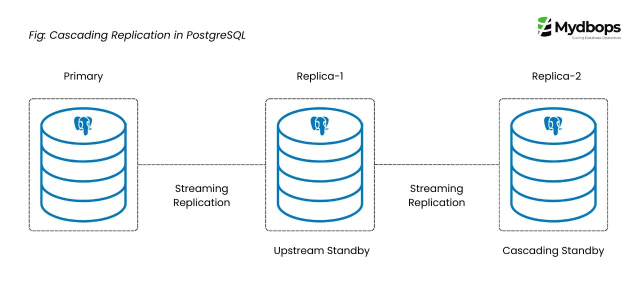

    There are three PostgreSQL servers. One is primary and the other two are read-only. Something like below:
    This database is related to a website where data is regularly entered. The server must be physically moved, and this move will take several hours. I wanted to create a clone of this VM on another host and connect the website to this new VM. Is it possible to live transfer this VM to another host?
