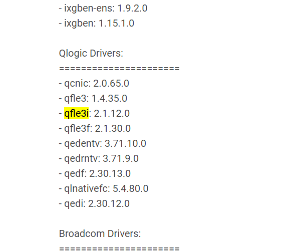

  • 2.  RE: Which ESXi 8.0 driver for this Broadcom/Qlogic NIC?
    Posted Mar 15, 2024 07:19 PM
      |   view attached
  • 3.  RE: Which ESXi 8.0 driver for this Broadcom/Qlogic NIC?
    Posted Mar 15, 2024 08:03 PM
    Thanks, should it work even though when I actually click that download link it takes me to a download that says it's for 7.0 rather than 8.0?

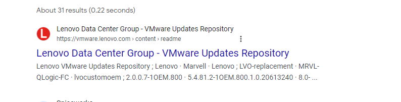

    After reboot I saw that it was out of compliance for patching, so I remediated and then the NICs were gone again and so was my qfl3e driver.  I manually installed the driver again and again was out of compliance.  The patch it wanted to apply was: "LVO-replacement_2.0.0.7-1OEM.800".
    I don't know what that LVO patch is, but it doesn't like the qfl3e driver.
    Once I removed that patch baseline I'm able to patch all the Predefined baselines and get a server in full compliance with all NICs showing.
  • 9.  RE: Which ESXi 8.0 driver for this Broadcom/Qlogic NIC?
    Posted Mar 19, 2024 03:00 PM
    From looking up the version after "LVO", it seems this may have been residual from some Lenovo servers that were once in the environment. So, it seems that if your organization moved from Lenovo to Dell, this should have been removed.
