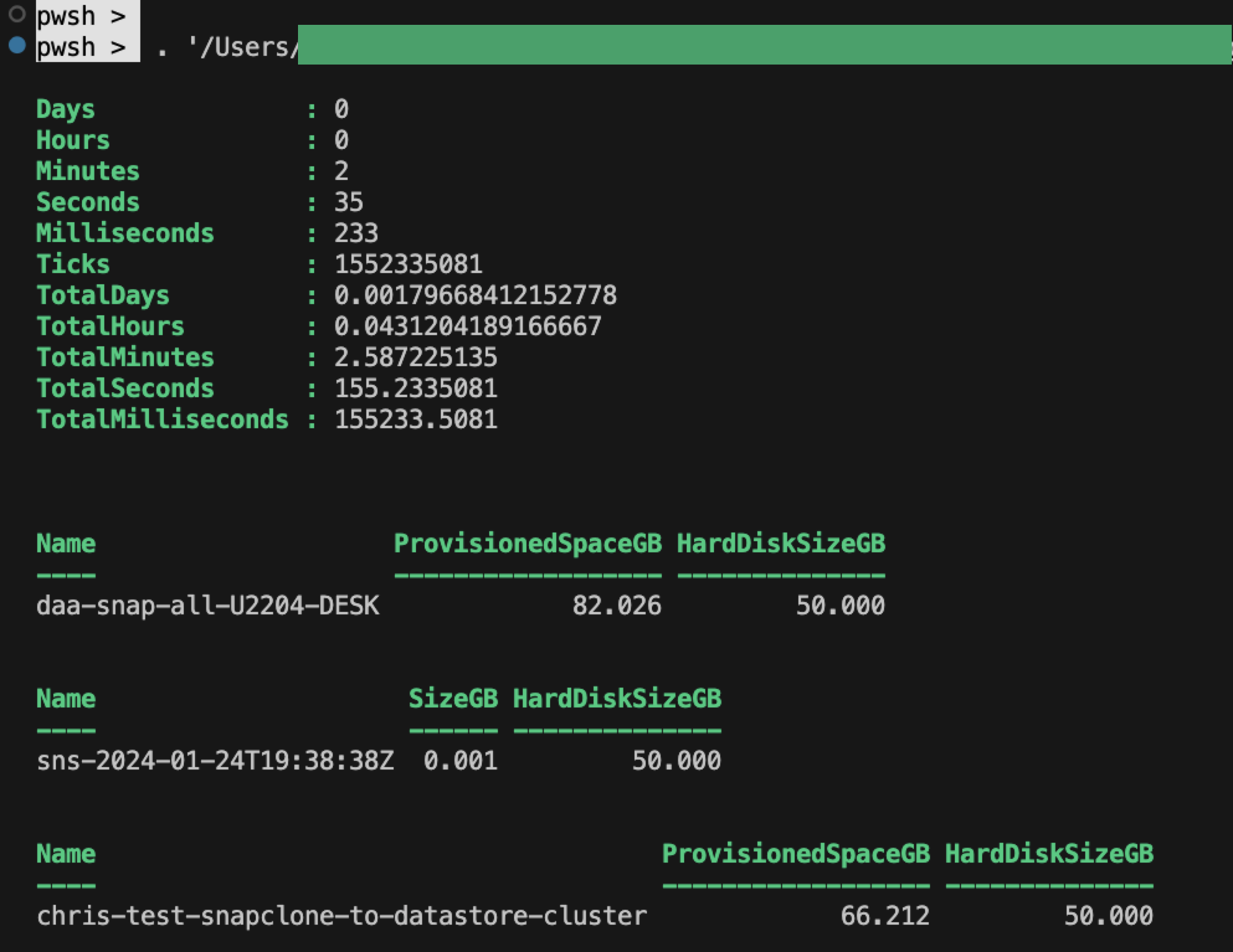

    My code creates a regular-clone when it should create a linked-clone, please help.
    # Confirm we can new-VM to a storageCluster
    # BUT IT IS NOT LINKED.  IT IS LARGE AND TAKES TIME TO COPY

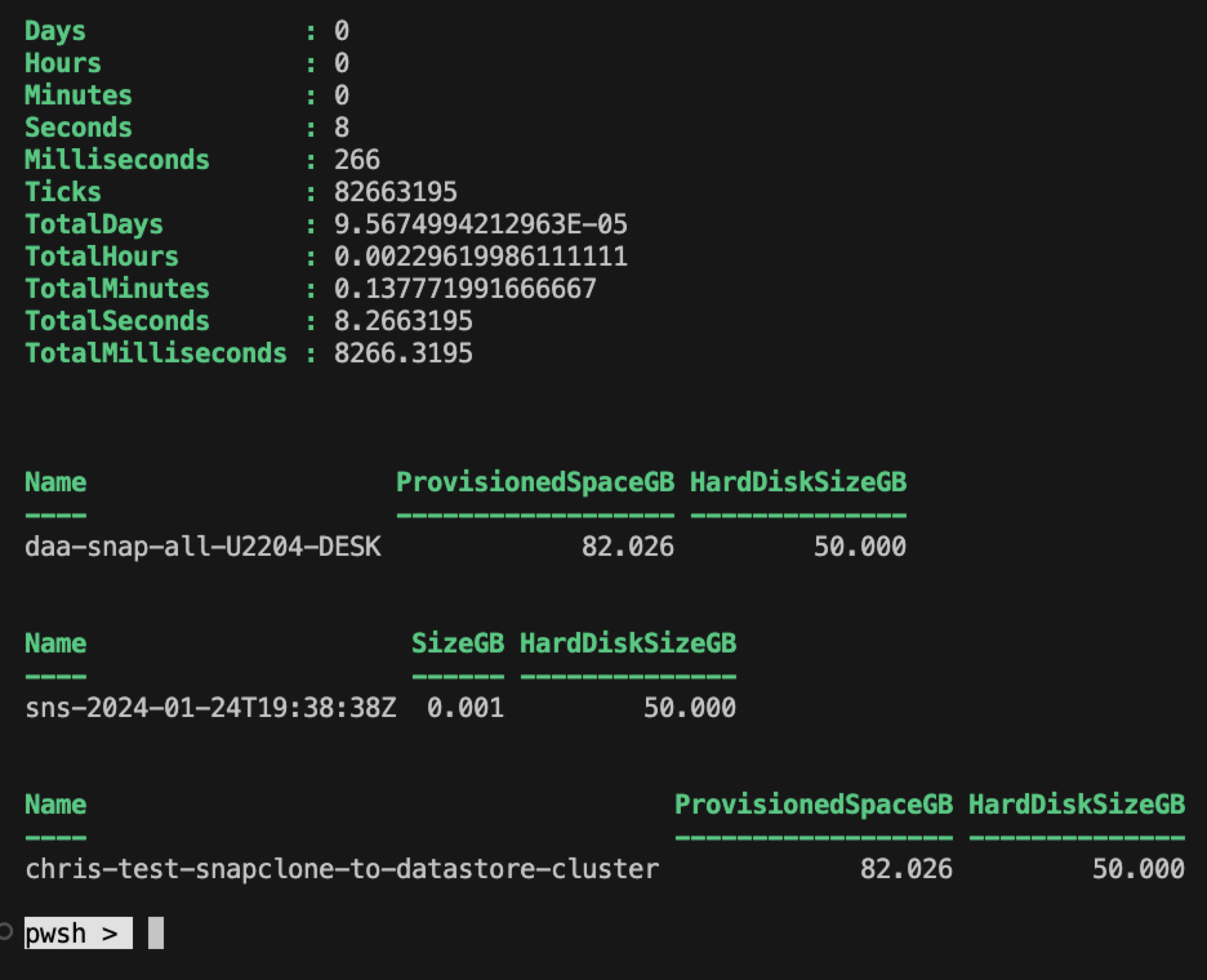

    Output is:

    Is the reference snapshot located on the same DatastoreCluster?
  • 3.  RE: Code creates a regular-clone when it should create a linked-clone....
    Posted Jan 30, 2024 05:54 PM
    Yes.  The reference snapshot is located on the same DatastoreCluster.
  • 4.  RE: Code creates a regular-clone when it should create a linked-clone....
    Posted Jan 30, 2024 06:07 PM
    Strange, it should work when on the same DatastoreCluster.
    For testing, can you try to create the linkedclone on the same Datastore as where the reference snapshot is located?

    I was able to successfully create a linkedclone on the same Datastore as where the reference VM is located.
    Changed the -Datastore to be the datastore of the reference VM:
            -Datastore (get-vm $BaseVM    | Get-datastore)[0] `
    Output is:

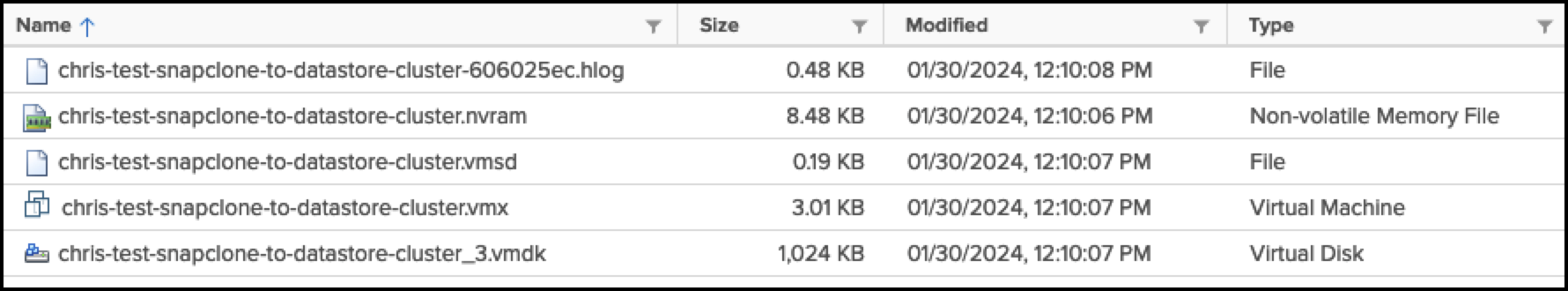

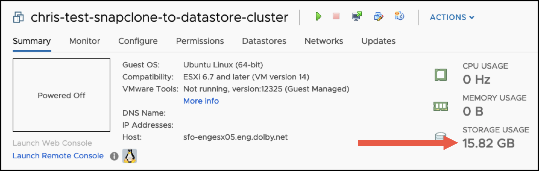

    Although the output shows "chris-test-snapclone-to-datastore-cluster" with a HardDiskSizeGB of 50.000, the actual size is smaller:
    Although the actual size is small, the vCenter GUI shows the new VM as consuming over 15.82GB of storage:
