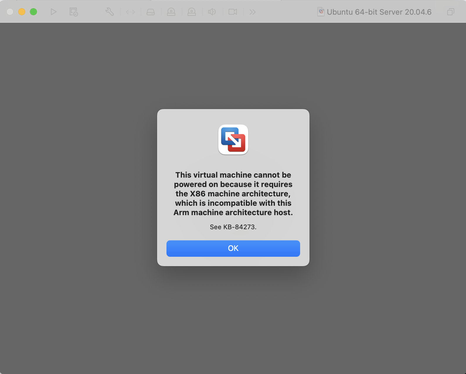

    I have just recently upgraded to MAC M2 Chip,  VMware running perfectly fine, whereas installing EVE-NG is failing. to install as the package is based on X86,  is there a way to install Eve-NG  or is there a ARM version.

    You can’t run an intel OS on an ARM machine - that’s like trying to run a gasoline car on diesel fuel.
    You’ll either need to find an ARM version, or switch back to an intel machine.
    There are CPU emulators like UTM, but the performance is very poor (basically unusable).

    There is no ARM version of the VM.  You will need to run EVE-NG on an Intel PC or Mac.
