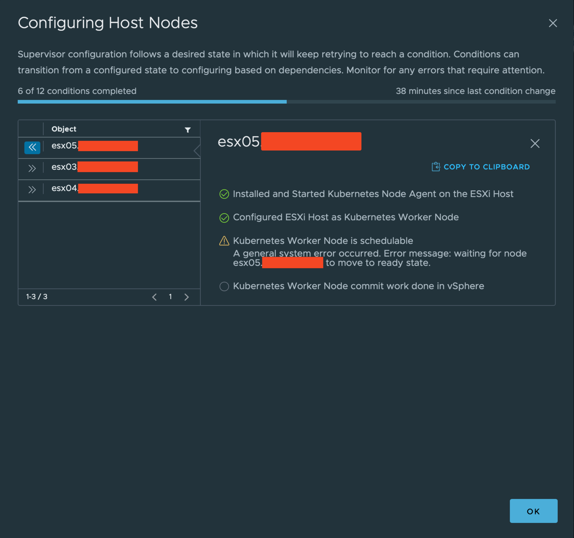

I am currently facing issues when deploying the workload management on my vSphere Cluster in my homelab. I'm using NSX networking + ALB, everything is setup according to the documentation as far as I can tell but the installation hangs on the host preparation. I can see inside vCenter that the task "starting service" for each of the ESXi hosts is repeated around every 3 minutes. The Spherelet service is running and is showing no errors inside /var/log/spherelet.log
On each Host inside the wcp setup there is a warning shown: "Kubernetes Worker Node is schedulable A general system error occurred. Error message: waiting for node esxhost1.example.com to move to ready state." and the configuration task is stuck at this point
The configuration for all work Supervisor VMs did complete and was successful.
