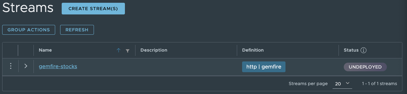

  4. Click on the “Create Stream(s)” button. A popup will appear, prompting you to enter a name for the stream. Type gemfire-stocks and click "Create the Stream(s)". Once created, you should see the newly created stream named gemfire-stocks on the “Streams” screen. Note that the Status will be Undeployed.
    Newly created Stream - gemfire-stocks
  5. Now the stream needs to be deployed. This can be done by clicking the stream name. Then click the button Deploy Stream. This will take you to another screen that allows you to confirm and/or configure the SCDF application properties as needed. Click the Deploy the Stream button at the bottom.
    It may take a moment for the stream to deploy successfully. To confirm their deployment:

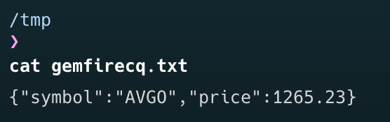

  1. Run the following command which should write an entry to the file.
    curl -d '{"symbol":"AVGO","price":1265.23}' -H "Content-Type: application/json" -X POST http://localhost:9098
  2. Check the file by running the following command in the terminal
    cat /tmp/gemfirecq.txt
    You should see the following entry.
    Image of a terminal window the output of the file showing 1 entry

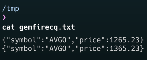

  3. Run the following command which should NOT write an entry to the file.
    `curl -d '{"symbol":"AVGO","price":265.23}' -H "Content-Type: application/json" -X POST http://localhost:9098
  4. Confirm that the entry was NOT written to the file by running the
  5. Now, run the following command again, with a different price, which should write an entry to the file.
    curl -d '{"symbol":"AVGO","price":1365.23}' -H "Content-Type: application/json" -X POST http://localhost:9098
  6. Check the file again and you should see two entries:
    Image of a terminal window the output of the file now showing 2 entries
