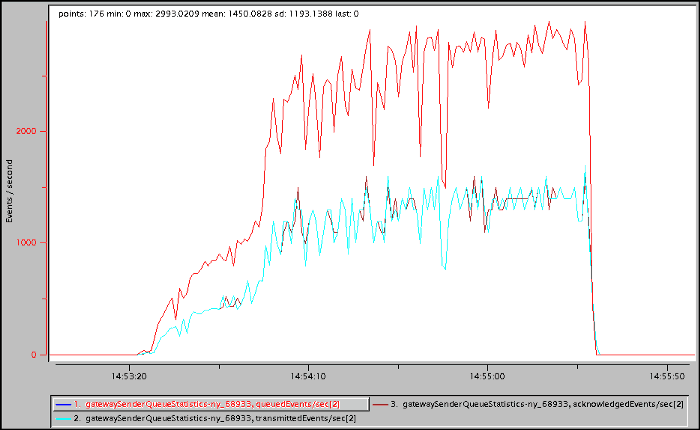

Queued, Transmitted and Acknowledged Events
This chart shows the number of events queued, transmitted and acknowledged for the specific GatewaySender.
This vsd chart shows the GatewaySenderQueueStatistics queuedEvents (selected), transmittedEvents and acknowledgedEvents

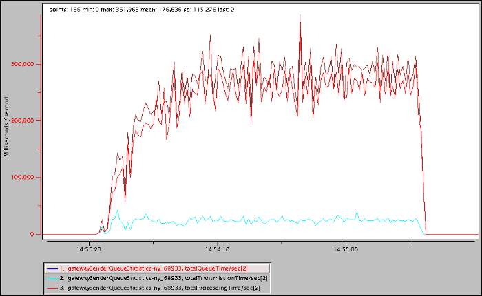

Queue, Transmission and Processing Times
This chart shows total queue, transmission and processing times for all of the GatewaySender’s events.
This vsd chart shows the GatewayenderQueueStatistics totalQueueTime (selected), totalTransmissionTime and totalProcessingTime
