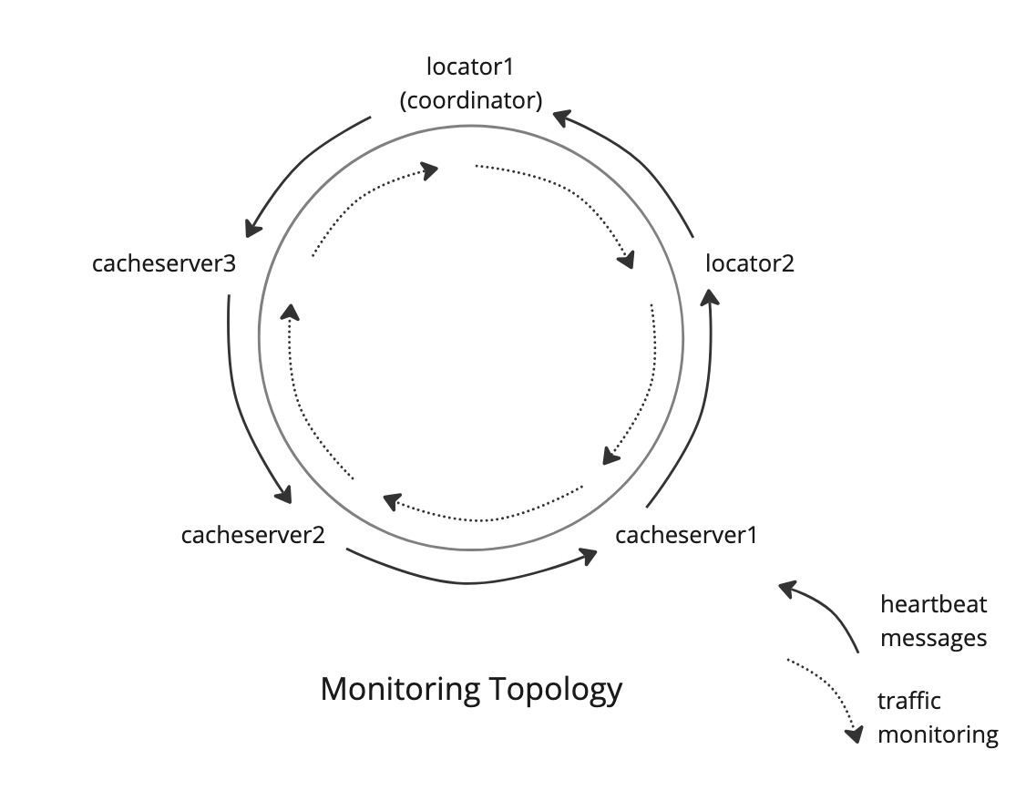

As we said earlier, each member's communication is monitored by one other member. You can think of the monitoring relationships forming a ring of members. It so happens that each member is monitored by the member to its left in the view. The left-most member is monitored by the right-most one, thereby completing the ring. In this example locator1 (the coordinator) monitors communication from locator2. If locator1 has no communication from locator2 for a long time, then locator1 will raise suspicion against locator2.
Monitoring Topology; heartbeat messages flowing in one direction, traffic monitoring flowing the in opposite direction
Heartbeat messages are generated in the opposite direction. Each member generates heartbeat messages to the member to its left. locator2 will periodically generate heartbeat messages to locator1. Under normal conditions, this will keep the traffic monitor in locator1 satisfied that locator2 is functioning properly, even if there are no application-level (put/get) requests being processed by the cluster.

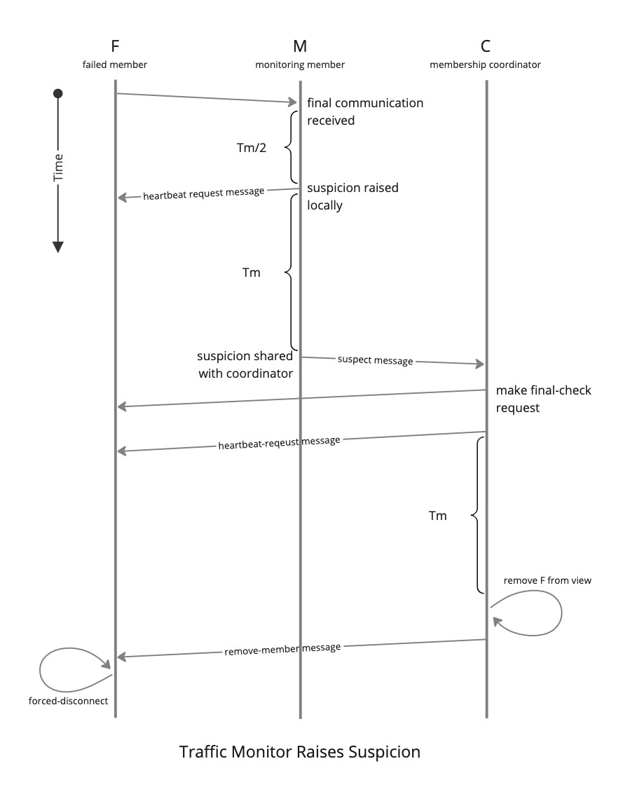

Here's a swimlane diagram showing three members involved in an escalation:
Suspicion Escalation Swimlanes; failed member, monitoring member, membership coordinator exchanging messages
M is the member monitoring communication from F, the member that has ostensibly failed. C is the coordinator. In this picture we see suspicion raised by a traffic monitor.
Whether suspicion (of a member) arises because of some failed communication attempt with that member, or arises because of a traffic monitor noticing a lull in communication from that member, after the health monitor receives a suspicion notification, the process is the same.
In this case, in the first (top) segment on the M line we see that F sent its final communication to M. Some time (Tm/2) later, having heard no further communication, M raises suspicion. That is to say, the traffic monitor running on M raises suspicion.
The first thing that happens after suspicion is raised is that the health monitor running on M sends a heartbeat-request message to F. If F is working properly, this will cause it to immediately send a heartbeat back to M. But if F doesn't do that in time (Tm) then suspicion processing will move to its next phase.
After receiving no communication from F after the "heartbeat-request" message, M sends a "suspect" message to the coordinator, C. Upon receipt of that message, the coordinator does two things. It sends its own heartbeat-request message to F, and it makes a "final check" request on F. The final check request is made over a new connection to F on F's dedicated failure detection port. If the new connection attempt fails, or if no response is received to the request on that connection, and no other network communication is received by C from F in time (Tm) then coordinator C deems F failed.
When the coordinator C deems member F failed, F is removed from the view. A "remove-member" message is sent to all remaining members and a new view, a view no longer containing member F, is distributed to all the remaining members.
If member F is able to receive any of this communication it will enter its forced-disconnect processing and shut itself down. If member F doesn't receive the new view and it doesn't receive the remove-member message it may keep running. But because the other members of the view no longer recognize F as a member, F will not be able to participate in any further cluster processing.
A number of decision points are visible in the previous diagram. At each point a health monitor (running on the monitoring member M, or on the coordinator C) will stop the escalation process if recent communication has been received from the suspect member. Notice too, that for suspicion to progress all the way to removal, two members, the monitoring member M, and the coordinator C, must have both lost contact with the failed member F. If M loses contact and escalates to C, but C has contact, then F will survive as a member of the cluster.
