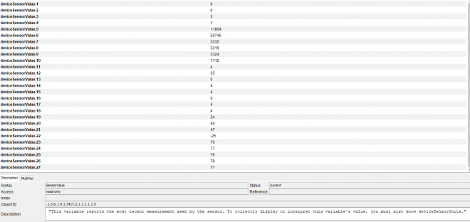

  • 7.  RE: Need a guide for the meaning of each OID in the MIB and its tree/relations
    Posted Jun 18, 2019 11:27 AM
    As shown in above screenshot, the OID ".1.3.6.1.4.1.3417.2.1.1.1.1.1.5" with name "deviceSensorValue" on the SSLVA can return all these values
    the same for the below objects:
    the question is:
    what is the mapping between the several values returtned from each of the above objects? it's supposed that the each value from the deviceSensorName should be mapped to its relevant of the unit, status, code,  ...etc
  • 8.  RE: Need a guide for the meaning of each OID in the MIB and its tree/relations
    Posted Jun 21, 2019 01:09 AM
    Hi Islam,
                     Yes, each of these values will be that of the respective deviceSensorName. If you do a SNMP get bulk in each of sub branch, you will get to see all of this as in below screenshot. I did for deviceSensorName, deviceSensorValue and deviceSensorUnits to get this
