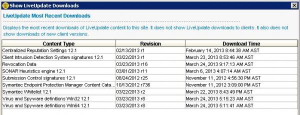

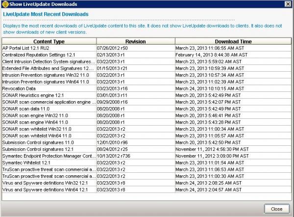

    When I compare the downloads on both the servers I see a lot of additional components in the one that was having problem. Below are the screenshots:
    Please let me know if this would cause any issue as the contents are different.

  • 21.  RE: SEPM unable to download updates
    Posted Mar 26, 2013 10:10 AM
    in sepm
    under admin
    servers
    liveupdate, check what components you have selected. compare this with the other one.

    Hi Rafeeq,
    I compared the components and they are the same.
    Moreover, I see that the issue has come back. It is now showing two days old version and liveupdate is giving the same result. It says the update is successful but it is not.
