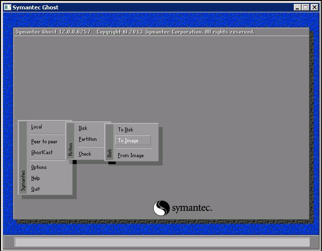

5. In Ghost, choose Local > Disk > To Image.

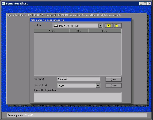

7. Make sure you select the mapped drive in the 'Look in:' dropdown menu at the top, then specify a filename for the image file.

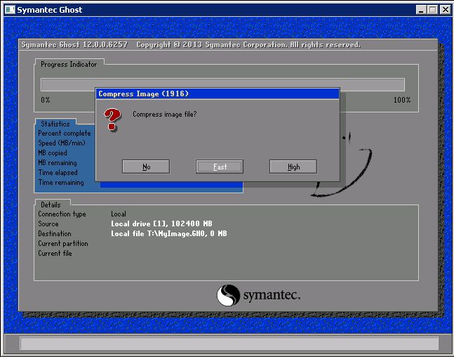

8. Select the compression level. We recommend using 'Fast' compression.
9. Proceed with image creation.

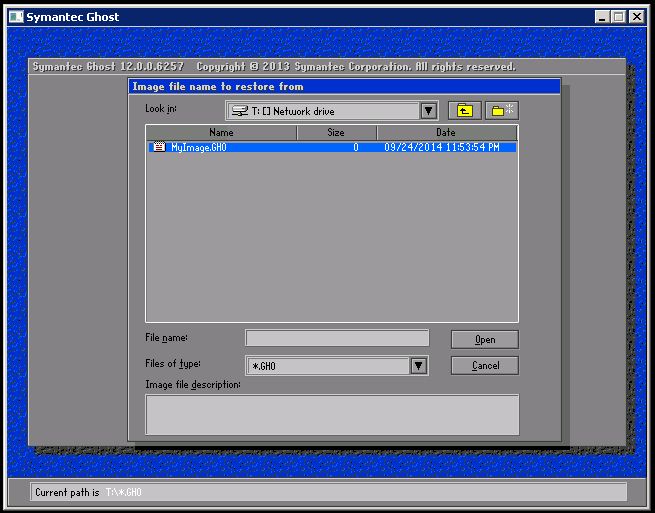

5. In Ghost, choose Local > Disk > From Image.
6. It will ask for the source image and destination drive. The source image will be in T: (mapped above). Select the appropriate *.GHO file. The destination drive will be the drive you are deploying to.
7. Proceed with image restore.
