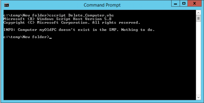

And that's it. From this point, just save the script and then run it,
In the case, the script found that the computer "myOldPC" didn't exist so displayed this info message (this is the line that's also written to the log file by the way).

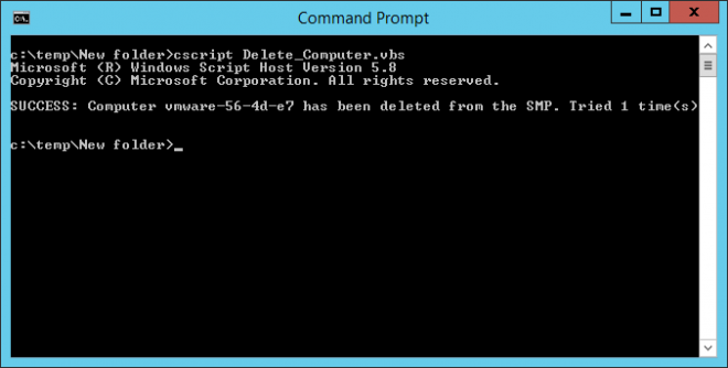

When a computer is successfully deleted you'll see this magic,
And this took a couple of seconds. Notice in all this that you didn't have to enter any credentials for this. All of this executes with the credentials the command prompt is running under.

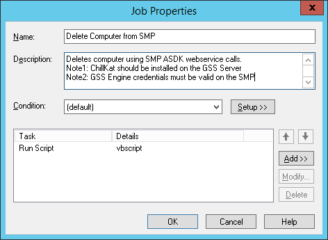

Creating Your GSS Job
Creating the job in GSS is simple,
  1. Create a New Job.
    Let's call it "Delete Computer From the SMP"
  2. Add a "Run Script" task.
    Embed this vbscript from this article.
  3. Script Run Location settings
    Set "Script Run Location" to "Locally on the Ghost Solution Suite". Uncheck the box "Run when the agent is connected" (this is so you can it even when the computer is offline).
  4. Set the 99 Return Code
    As the script exits with exit code 99 when the object can't be located in the SMP for deletion, we need to have this set as a success code. Success because the object isn't there now (which is what we want), but we might want to know that it wasn't there in the first place.
And that's it. Give it a whirl.
